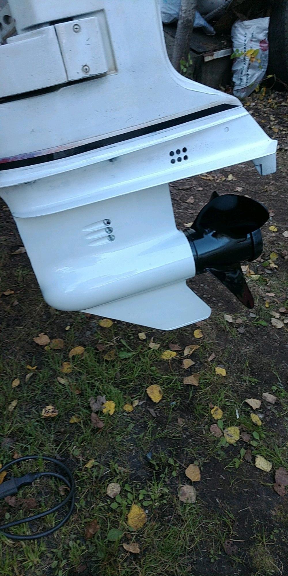

Sorry, I had a tough time posting the picture. Yes I have sold many lower units on eBay. I'm a charter member. Lower units are clean here in Northern MN. Since I mig weld aluminum, it's great to dress em up and paint. They are relatively easy to package and ship.
