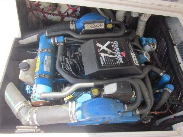

Hello all...
I am attaching a photo of one of my new to me 454 FWC engines.
As a humble man I was hoping someone could basically dumb down the cooling system "pathway."
I have an obvious general understanding of Marine cooling systems, but i'm not 100% sure of exactly what would be subjected to raw water in this system. Obviously the risers would be, but how about the manifolds in this engine?
Any explanation of the hoses running to and from the heat exchanger would be appreciated.....
I guess i'm wondering where the RAW water goes?? and doesn't go...
Picture will be on following reply as I'm having issues attaching it with text here... apparently i'm technologically challenged as well as cooling system challenged...lol....

OK.... I've marked up your picture to show which is which, etc.
Seawater is pumped into the shell and tube style Heat Exchanger, and passes through the tube bundle.
Your engine has ethylene glycol (coolant) being pumped through it, and additionally through your manifolds.
The hot E/G coolant returns to the H/E and sorrounds the tube bundle.
As the seawater passes through the tube bundle, it removes engine and manifold heat from around the tube bundle (the E/G side of the system), much like air does with a Car/Truck radiator.
So basically, the car/truck radiator has been replaced with a Heat Exchanger, and the air has been replaced with seawater.
The "spent" seawater is then directed to the exhaust elbows, where it then eventually blends with the exhaust gasses.
Ricardo you're amazing and NO offense taken. I do know the basics but that graphic sure was helpful!! It's posts like your graphic that will forever be archived on this site to continue to help others down the road who might be afraid to ask. Your input here is like no other i've seen. Thank you.
So back to my ignorance. I other question.
How about the actual exhaust elbow that is to the left of "I" between the rubber exhaust hoses.... That cast iron elbow... it sees sea water and exhaust gasses so how often do they typically need to be examined???
You are too kind, thank you!
Good question.
If you are speaking about the part to the left of the "I", that joining elbow looks to be fiberglass, and can be removed and inspected.
If you are speaking of the actual cast iron exhaust Elbow (where you see the rubber exhaust coupler connecting to it) ...... just inside of this area is the seawater mixing chamber.
There will be a small port or series of ports where the spent seawater blends with the exhaust gasses (shown by the arrows).
These will eventually rust up and become restrictive, and when they do, we typically begin to see over-heating issues.
Sometimes these ports can be cleaned and cleared, yet often in salt water it's a lost cause and requires replacement.
I'd suggest that you periodically pull the elbows and inspect them.
However, in your scenario you'll likely not need to replace your manifolds.
On open systems (raw water cooled) the seawater transfer ports also become rust restricted, and again we typically begin to see over-heating issues.
Yes I was referring to the elbow to the left of the "I" which appears to you to be fiberglass... Basically it's the BLACK Colored elbow i'm asking about
I never realized they used Fiberglass in the exhaust system... So towards the stern there is another exhaust elbow is that likely fiberglass as well??
(This boat is new to me and still out of state otherwise I could go outside and touch it and know...lol...)

1..... Your oil cooler is to the right of my "F" (in the marked up photo), and I believe this is what the guys refer to as a U-cooler!
Seawater enters the cooler at the lower area in the picture, and exits from the upper area in the picture, and heads toward the Heat Exchanger's port "I".
