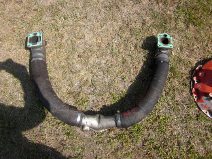

Here's some photos of the exhaust swap.

And here's the 360's exhaust system (formerly mated to unknown outdrive) mounted to my old 318's 270 Chrysler transom plate.

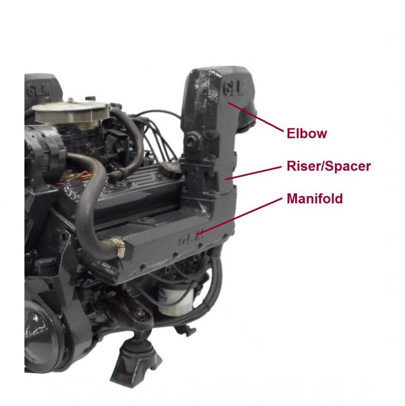

Here's a a typical heat riser with elbow setup.

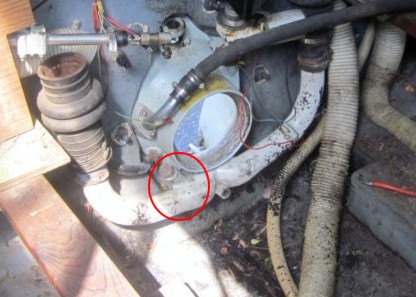

I posted photos of the exhaust setup with sealed off auxiliary port which you indicate is probably for back pressure relief when the boat is sitting idling. Makes sense. I see at the end of each manifold there are large ports sealed up with plugs and presumably I can simply pick up two threaded hose attachments, hi-temp hose, and clamps to connect the left side manifold to the sealed off back pressure relief port at the exhaust fitting connected to inside of transom shield (see my second response with photo of it circled) . Good to know what that plugged port was used for. I wonder why it was sealed off? The solid Y-tube exhaust, supposedly from a 280 outdrive, is rather narrow diameter but for my purposes I don't think it will be a big issue. This is a fishing/camping cruiser, not a speed boat. I'm also thinking the back pressure relief while idling issue might have been more important for maintaining idle of lower hp 318. Maybe not so much for the larger engine? If this Y-tube doesn't work out I can simply switch back to the old setup with longer exhaust hoses to meet risers (and some 45 degree solid exhaust joints rather than bending the hose). The probability of finding a larger 280 Y-tube exhaust is rather remote in this remote backwater.
The part that is being shown between the exhaust manifold and the elbow is a spacer or riser.
Not all exhaust systems use a spacer/riser.
Yes, that would be a low pressure exhaust relief port..... (not an auxiliary port).
Actually, the original elbows (had they been Volvo Penta) would have been ported from directly within the exhaust gas chamber...... not from within the seawater side.
Volvo Penta did this
for the GM 5.0L V-8s with the AQ200B and the AQ225B.
Chrysler apparently followed suit using their own components, or possibly Eaton components.
The 3" Y-pipe was used with the smaller 335 series Fords and the smaller GM v-8s.
Again, Chrysler apparently adapted the use of this part for their 318.
Typically the 360 would have been equipped with a larger diameter Y-pipe.

Risers or Spacers are used to separate and raise the Elbow up from the manifold's mating surface.
This is done in scenarios whereby the water-line is too close to the Elbow's interior "turn-down-bend". Deep V hulls whereby the engine sits low in the hull.
The idea is to get the Elbow elevated as to prevent a wave-surge from forcing water into a cylinder at low speed.

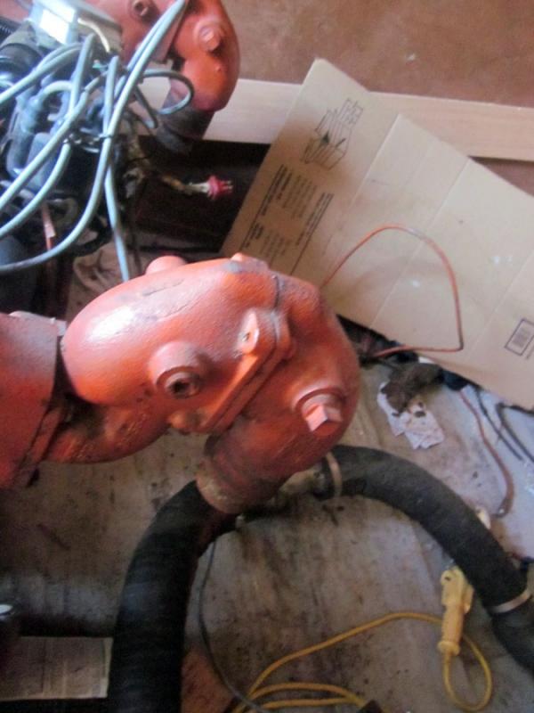

Thanks for clearing that up Rick. My idea wouldn't have done anything to relieve exhaust pressure. I'm thinking that making that Y-tube work is just too much hassle. Given what I have for manifolds and risers, I would have to add welded fittings and frankly I'd always be concerned the welds would fail. Too much vibration. This Y-tube is probably too narrow anyway. I'll use the old 318 hose system with the enclosed exhaust relief built into the Y-fitting that bolts to transom plate, but I'll add two 45 degree elbows to relieve the current stress on the bends in hose. Should have done that years ago. I seem to recall West Marine sold some fancy hi-temp plastic exhaust fittings. Do those hold up?
The 360's manifold to U-risers: (the old hose exhaust system for 318 is laying on floor behind it)
So, though the 318 only ever had 90 degree elbow risers instead of U-risers and seemed to do fine with it, should I still keep the inverted U risers that are on the 360? As you can see from transom photo, the hull is quite deep but I suppose a large swell coming at the transom could possibly back up into a cylinder without the U-risers? Surprised this system was put together at factory without U-risers. Or maybe it's not necessary?

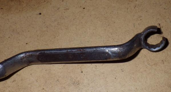

So those stupid risers. The bolt in the pocket to the manifold, a normal crescent wrench does NOT fit. I just bought a pivoting socket in hopes it'll clear.
I was able to get at my manifold bolts on one side with crescent wrenches and sockets on extensions. The other side has a long metal tube running from the elbow which seems useless and dumb blocking 3 of the bolts. I may cut it off and see if i can get the manifold off through deck access then just do the barb at the elbow to replace it.
