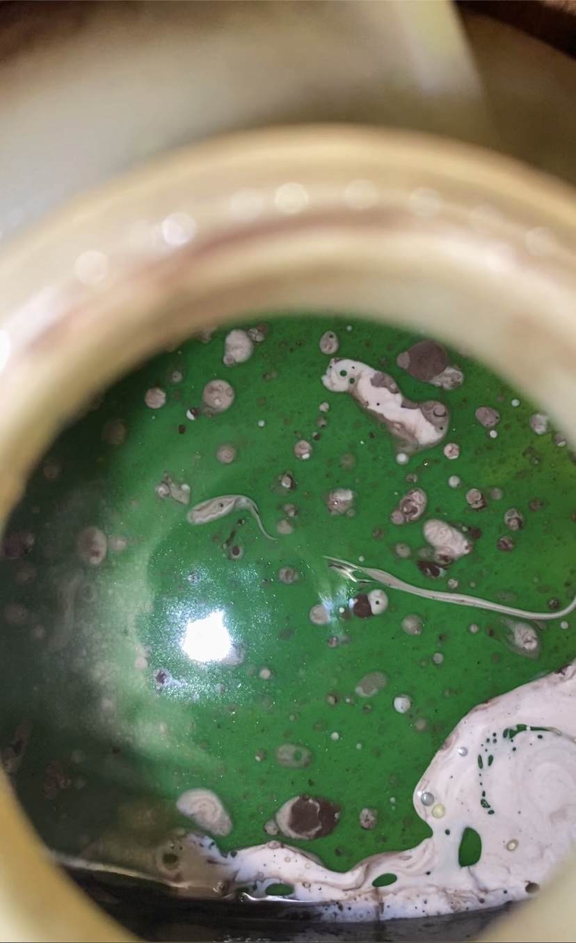

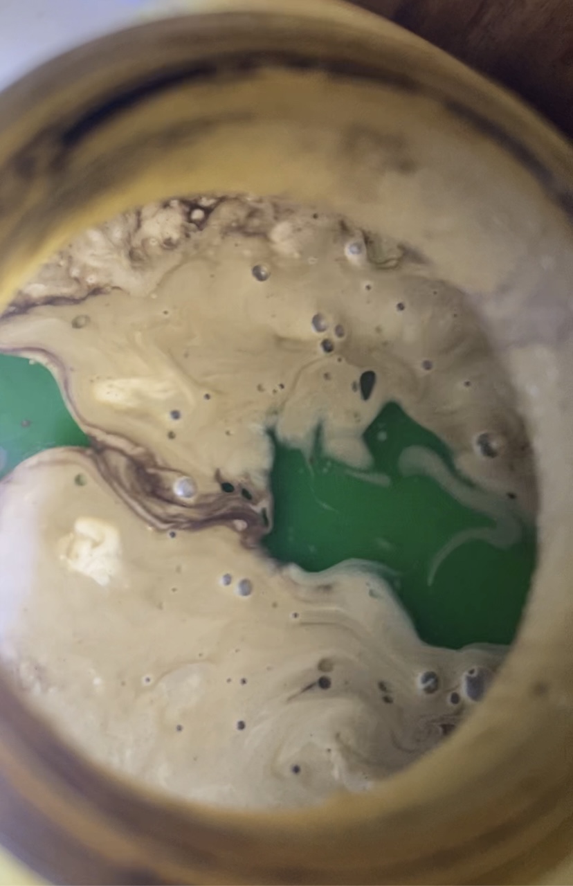

Having issues with a Sigma 41 coolant issue.
Issue is thick silver / grey sludge in coolant reserve / heat exchange.

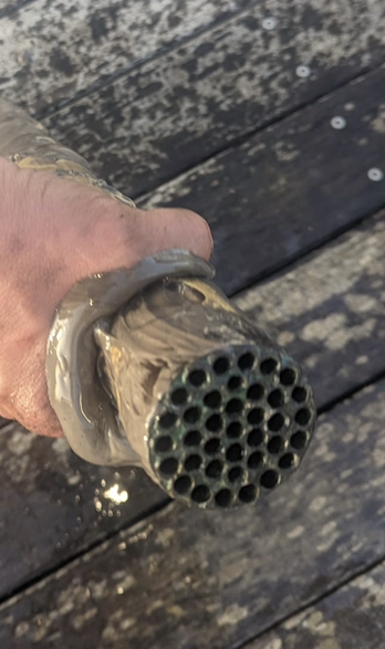

Opened up the heat exchange to find it all coated in the sliver grey sludge
Cleaned out and flushed with a hose as much as possible

Decided to open up to check sludge - still loads of the stuff.

To summarise around 2 months of sludge issue 10/15 flushes. Not much getting completely rid of it however it is now more liquid like and floating to the top of coolant reserve.
