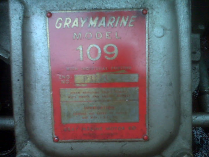

I have a 1960 Century Ski Dart - 109hp / engine model P3743.
My boat was hard to start and would not stay running after I put in gear. Marine Repair shop said I had "stuff" in my filter/line and probably the tank. They said I had debris stuck in my needle valve (?) Where is this and how can I fix it when it clogs again to avoid $85 charge?
