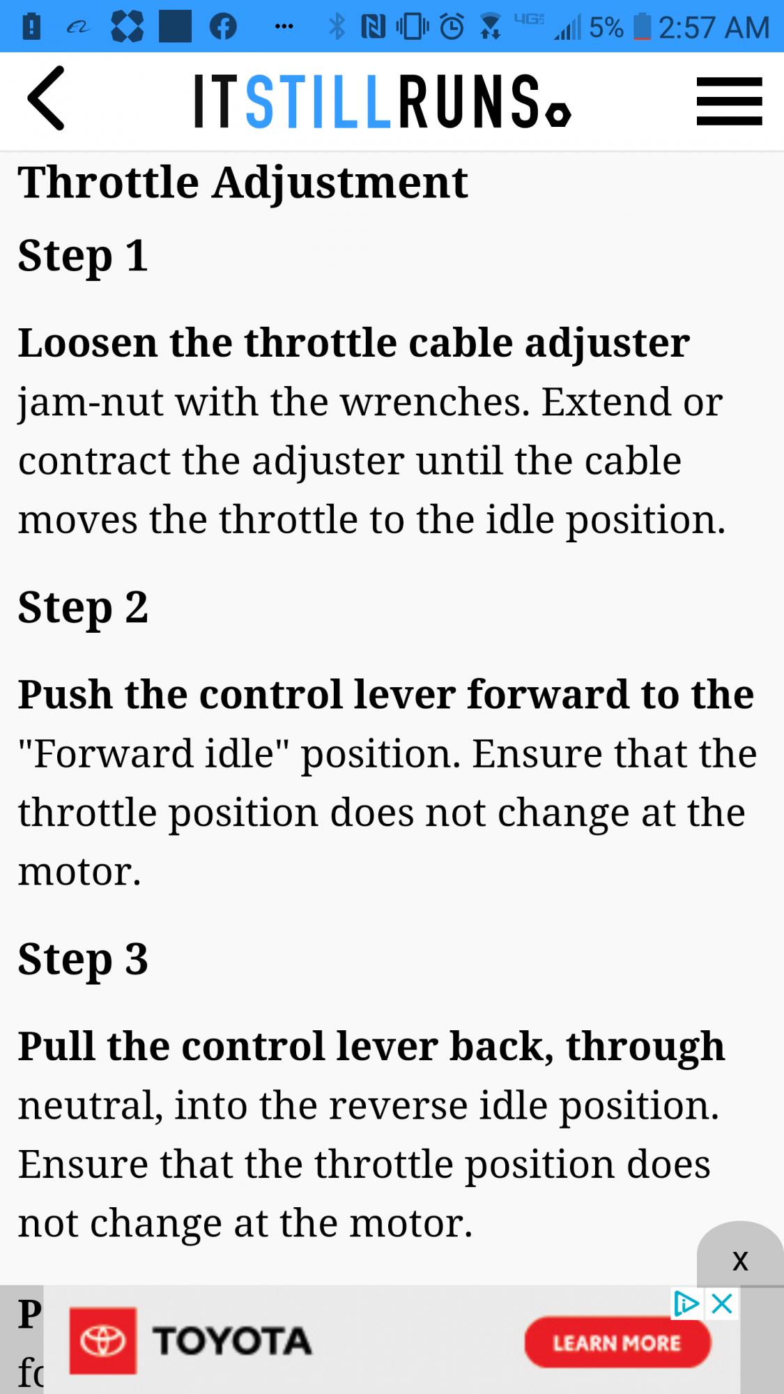

Ok I'm having a hard time still I'm sure I'm over thinking this how do I line up throttle on motor with control box. Please some adviceScreenshot_2020-04-13-02-57-24.jpg

There is a warm up lever ( throttle only ) on most control boxes.------The big lever shifts the motor and then applies throttle as you push it further.----Post pictures as that will help explain what is going on.----Did this problem develop suddenly ??
