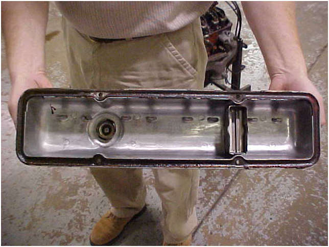

Here are the OEM GM LT 1 inside with the "drips"
