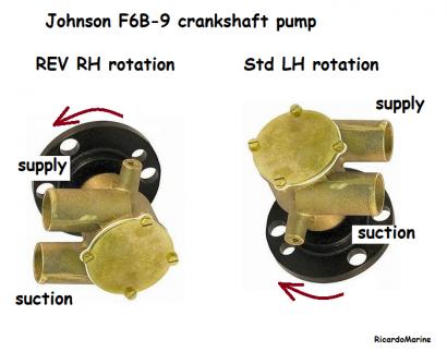

The inlet/outlets can be oriented to suit your suction hose and supply hose configuration.
For a Std LH rotation engine, and with both ports at 3:00 O'clock, the lower port is your suction port.
For a REV RH rotation engine, and with ports at 3:00 O'clock, the upper port becomes your suction port.
Or....... you rotate the pump body to the 9:00 O'clock position.
