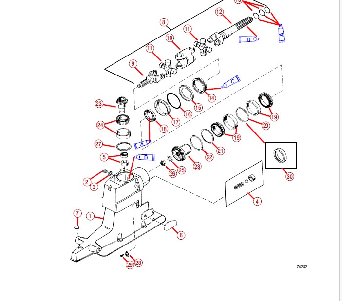

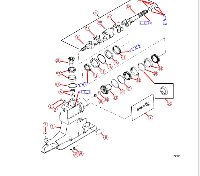

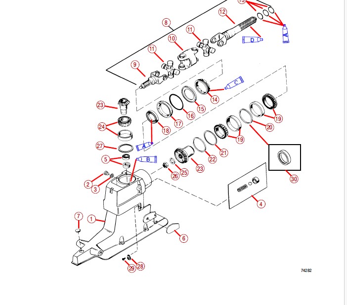

If what BT doctor said is true, below is a parts diagram of the upper gear case showing the parts.
Items 16 (Oring) 17 & 18 are the carrier ring and seal [item 18 -This is what may be the issue] Typically 17 & 18 come pre-assembled or you can purchase the seal itself and press old one out and press new one in to seal carrier ring.

any chance you could drop a part# or a diagram? i’m a little lost here, i’ve worked on plenty of boat engine but never any drives.

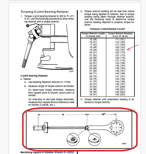

The correct torque wrench would be a 0-15 inch/pound dial type. Click is not reccommended.
I have a 0-15 inch/lb CDI #151LDN with certificate. 1/4 inch drive.

That spec is wrong, Its a different value with a specific length torque wrench and the tool for the large retainer nut. 18 inch torque wrench as shown in manual with wrench make the setting on torque wrench 123lb/ft. Which if only using a torque wrench it would be 200#. But with the added wrench to the torque wrench it becomes a torque multipier....thus the lower setting on torque wrench.
The shaft nut is completely different. (Rolling torque)

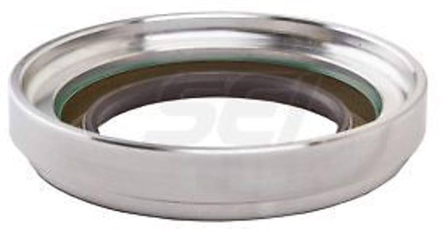

Below are two images.
1. Wrench needed for retainer nut if you have a upper carrier seal leak
2. The seal and carrier as an assembly (purchased this way from Merc if you choose and if needed) other wise you can buy the seal alone.

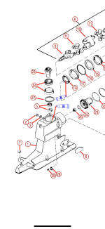

okay so one more newby question for you gentlemen before i get my hands dirty. if my bellows are dry is there a chance it could be the oil seals on the downward shaft leaking and weeping from the hole? i believe they are seals #5 on the diagram.and if it were those two seals would i be able to reinstall the drive shaft without replacing the input shaft seals or would you recommend replacement after removal anyways. i know a guy at a marine shop out here who i can just drop the shaft off to to be replaced and torqued properly so i dont f#ck anything up.
on a gen 2 for seal % you have to remove the lower drive shaft bearing cup. Small slide hammer will get it out. just keep track of the shims as they set gear height if I recall correctly. if bearings are not replaced in theory put same shims in and should be ok.
