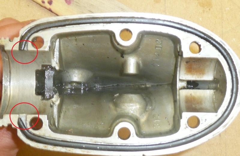

I noticed the gearcase oil on my 1973 6HP was milky, which I understand means that water is getting in. I decided to open up my first gearcase to see what the issue is. I looked at the gearcase parts diagram on this site and ordered: 303360 — "O" RING,GEARCASE HEAD, 313282 — OIL RETAINER, and some spagetti seal (I think that's what it was called) to replace the one between the two halves of the gearcase as the part wasn't listed here to buy. A forum post had suggested the spagetti seal and some Permatex 518 gasket maker.
I'm assuming replacing those three parts should deal with the leak. Maybe they all weren't necessary.
I have a few questions:
1 - how do I remove the oil retainer? It's fitted into the head bearing, which is an expensive part I'd rather not damage.
2 - should I put a bit of the Permetex at the ends of the spagetti seal to ensure a good seal? I've attached an image of the lower half with the old seal in place. You can see that it doesn't reach right to the head bearing.
