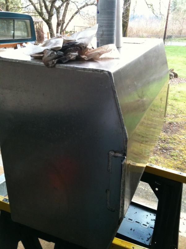

I own a 1996 Campion Explorer. One day I filled the tank full. I noticed a tiny, tiny, periodic dribble of fuel coming from underneath the gas tank and into the bilge.Thanks to Campion's poor design, I had to cut out deck in order to remove the tank. Now the tank is cleaned and sitting on saw horses, I pressurized it and gave it the soap bubble test. I can't find the darn leak! UGH! Maybe I should fill it with gas and then see where the leak is? It only leaks when filled past 3/4 level. I hope to find the leak, fix it and reuse tank. If not than I will replace it with a poly tank. anybody know a distributer of that sort of product?
