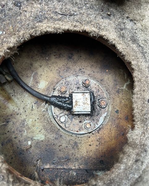

I have very limited access to the internal engine. What I do have access to I have attached in this pic. It looks like a rubber sheathing is melting/dissolving. But I have no idea what that cable is. I started to take off the screws holding that plate down but gas started to come out, so tightened it up to do more research.
That’s your fuel level sender for the gas gauge. You need to find out where the fuel line for the engine connects to the tank. There will be a barbed connector that the fuel line from the engine connects to. Then there is a square head fitting that the barbed fitting screws into. That is the fuel pick up tube. The other end of this goes down nearly to the bottom of the tank. These can have a screen on them that gets clogged with crud. I would definitely try to get that out & check it.
