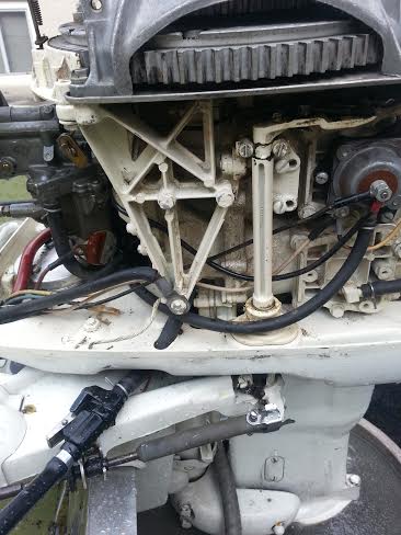

Here's a picture of the carb, and throttle linkage at motor, I used my finger to open the carb up and it still didnt climb much rpm. Sounds deep throaty , little boggy, no real power, struggling; u know.
( I took off low speed Rich/Lean cap to tune with it easier.)
Should I mess with that fixed position high speed more?

Do you have spark on both leads that will jump a gap of 1/4" or more ?-------Have you run with a timing light hooked up to one lead at a time to see how spark behaves at full throttle ?----Have to removed the linkage for the high speed needle so you can dial it in with just the needle itself ?
haven't done much of that but will; thank you, just using a digital tach.... I just gapped the plugs out a bit actually, and did a test ( think I leaned high speed out a bit (as much as i could with that actuator ; it wants to cut out if u get on the gas to hard, however I got her over 4000rpm this time, and she screams:)

This motor is a little different than my old 6 horse and 9.9 johnsons, its got a different sensor or something I'm not used to on the carb and it goes up over the flywheel (also attaches to throttle on carb, you can see the spring i think on or near it in the picture if you look above the carb near the flywheel). Ive also never used remote controls before, or an electric start either lol. so this is a learning experience, thanks.
That spring thingy above the carburetor is just a safety device.------Prevents you from using the recoil if throttle is advanced too far.
Ohh okay that makes sense. thanks

that collar and screw you posted , thats the front mixture screw? can't see anything else like that.

oh ya i tightened that up earlier where it looked like it used to be, it was floppy

This is the throttle cam on the points plate you want the throttle butterfly on the carb to begin to open as that mark passes the pointer the closer the better. You can clip a alligator clip with a strait paperclip on the throttle shaft in the carb and that will tell you exactly when the butterfly begins to open. You cannot adjust the carb until the motor is on the water and in forward gear only turn the needle 1/8 turn at a time and wait 10 seconds between adjustments. At idle speed engine up to temp only turn the slow needle first in until the engine cuts out and back out for a smooth idle Then point it toward the big part of the lake and only adjust the high speed needle for the best performance. Then go back to idle speed and adjust the slow needle again the same way and once you find a nice smooth idle add 1/4 turn rich counterclockwise. That helps for cold starts and protects the motor running slow speeds for long periods.
