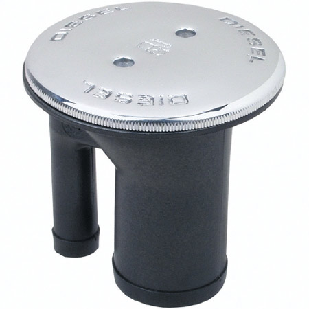

Did you verify your sender is working? Here is a picture showing a filler with an air vent connected back to the filler cap ..
Yesterday I reached next to under the cap and it's a similar to above drawing. I followed it to the tank. I disconnected it at the tank then blew in at that end and clear all the way to the cap. Boy now I'm really confused. I guess when I filled up originally I did it too quick (from a container on my lift) and that must have filled the air hose with gas just enough to make it overfill at the cap. I'm going to try one more time to fill it and just go VERY slow this time. Thanks for help guys.
