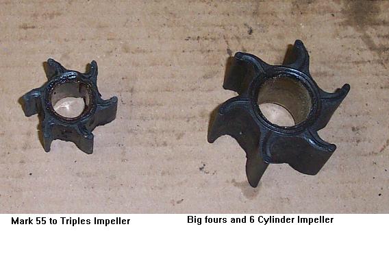

On the size (under size, actually) of that motor's impeller, check out the photo below. The small impeller was fine for 40 hp twins and even 50 hp fours, but it was a bit under-sized for a 70 hp triple. Conversely, the giant impeller was too BIG for the smallest engine used in, the 65 hp fours. (The largest engine it went into was the 150 hp sixes.) They tended to run too cold, causing piston scuffing problems. The sawmill operators loved them, however! They ran forever shoving log floats down river.
