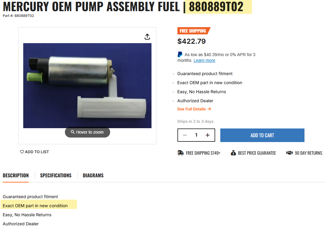

I decided to replace the fuel pump with OEM. Maybe that Amazon Chinese pump wasn't up to snuff. Called the Mercury dealer. Guess what's not available anymore. He was very helpful and directed me to the wide variety of pumps available on Amazon. :cautious:
So I procured a different brand of fuel pump. Installed Saturday and took her out for a run. Same issue. Not revving high enough to plane. Local dealer is backed up a month and vacation is in 2 weeks. Where do I start, please? Coil packs maybe? Plugs are new. The vapor separator float chamber feeding the injector pump had plenty of fuel in it so I don't suspect the inline diaphragm pump. Would a failed pressure regulator allow the motor to run fine at idle but not develop RPM as the throttle increases? I should probably check the fuel pressure.

Why is that? Seems that the motor makers would be wanting to sell as many high tech and expensive parts as they can sell.
