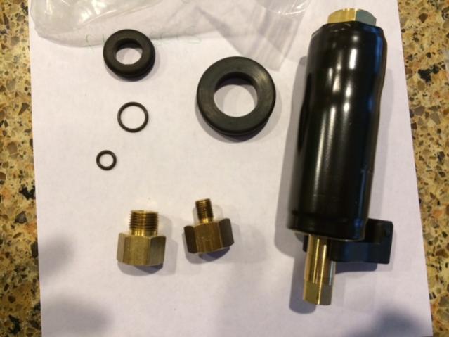

Thanks for the replies guys. Attached is what came in my kit and also a diagram out of the parts manual. If I understand correctly, I use the Loctite on any threaded items. The O-rings I assume go over the threaded shafts as well, correct?
Thanks again for the help!
