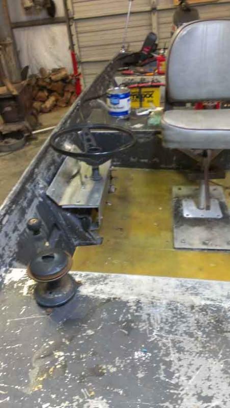

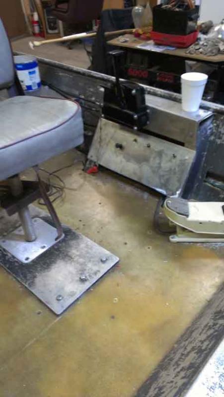

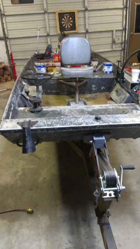

if its all welded and no rivets then its probably 100 gauge....and if you back off the throttle to 4k or less there wont be a hell of a lot of difference between it and the 25 running WOT...i think everyone is aware of gas usage with todays prices...
