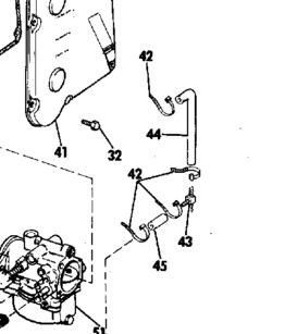

I just broke the plastic "T" on the carburetor fuel lines.
It does not show on any of the drawings.
I assume I could just get a 5/32" brass one at the auto parts store?
Jim
Sure, they show it. Item #43, part # 313537, right here at Marineengine

Thank you!
I was looking at the wrong drawings.
Is 5/32" the correct fuel line size.
The old T was 1/4" which I don't think is right. Fuel lines have grown over the years.
Jim
Parts list shows the hose as being 5/32" I agree, elbows might work as a substitute for the bends, but I have no source info.
