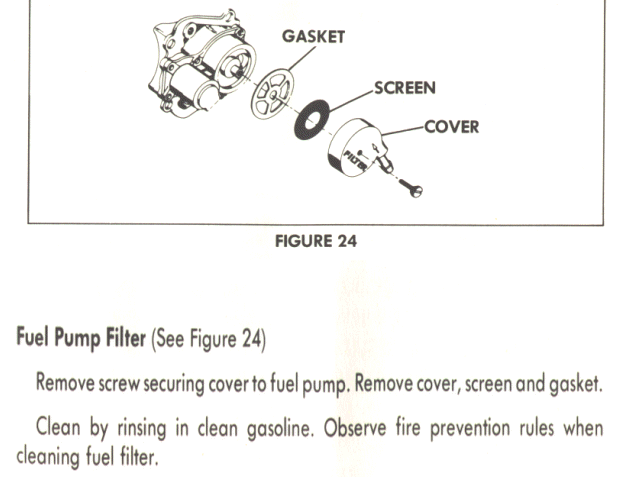

hello i got a 90 model force 150hp on the right side of the motor i think it has 2 fuel pumps and on the cover it says fuel filter. Can anyone tell me if that is what i am looking for to replace the filter in that case? thanks sorry a newbie boat owner here, trying to learn alittle about them ..
