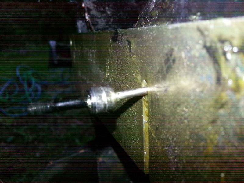

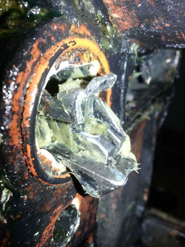

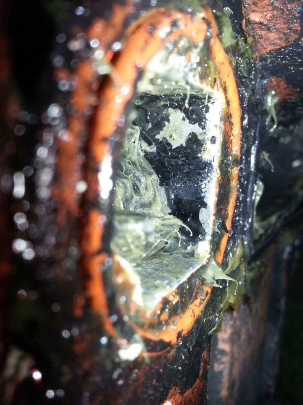

I pulled the drive and tried to reinstall, tried to pull shift linkage out again, picture shows the max. limit of extension it was a fail. So i brought sterndrive back home. findings and pictures to follow.

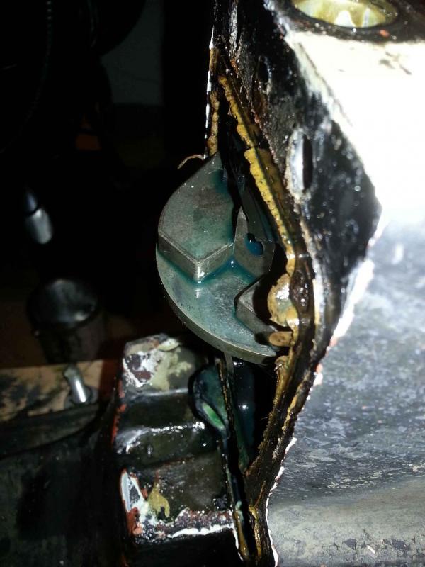

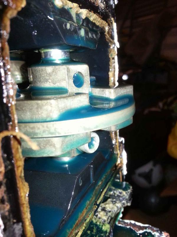

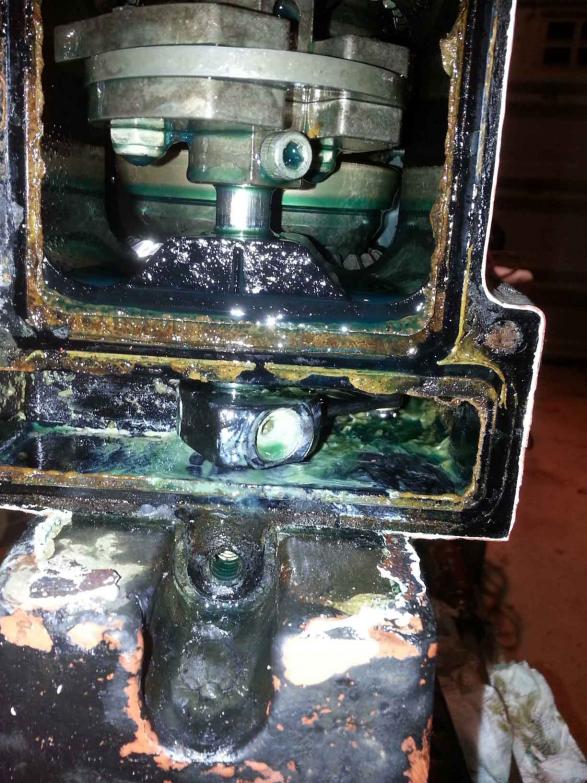

with top and back cover removed the shift assembly long arm was in a far back position and yoke shifter was in a far left position, it moved freely from left to center, but not past centerline of the drive, This you know it attaches to shift linkage assembly, thus keeping the shift linkage from coming forward.
I lightly lifted and teased yoke cam assembly and pushed/pulled the shift linkage and now have finger easy movement of shift linkage to proper position to reach barrel and shift cable.
shift linkage moves forward and back, yoke assembly is now on the right hand side of drive and moves freely between right and centerllne of drive. Yoke assembly does not want to move past centerline of drive freely, it will do it if forced and yoke assembly is teased.

First I will say that a cone clutch shift system as this does not move easily when not spinning. This is why it MUST be in neutral when removing drive.
I am not sure what all that dark stuff is?????
The link that goes thru the housing and has the fingers on it....have you removed it?
This link can corrode badly and cause shifting issues. It gets very sloppy.
I would gear oil the crap out of the cone assembly and grease the crap out of the linkage that is not exposed to gear oil and see if that help.
other wise the cap has to come off and inspect the cone clutch assembly.
Also that double disk assembly that pushes the cone clutch can wear have you looked at that?

Tuesday night my dinner date with the sterndrive, I reset the shift cable at the bilge and bell housing, I reinstalled the drive with the shift Linkage Jaws moving freely forward. Throttle shift assembly now in place and in neutral, boat starts from neutral position. I have forward and reverse spinning motions on the propeller shaft and I am able to shift into drive and reverse. repeatedly with RPM change.
conclusion,
Sterndrive shift linkage assemble and Yoke cam and Yoke shifter became jammed in between the forward and reverse gear and held in the jammed position by the back cover and the Detent Assembly and unable to right itself from the Controls Throttle Shift Assembly. possibly a wear issue for concern or user error.
fix.
removed top and back cover assembly on the upper drive, teased by hand side to side the U-Joint/Yoke Assembly while giving vertical lift to the Yoke/cam assembly. which freed the shift assembly to correct position.
