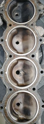

Force 120 1995 engine has been running poorly at heavy load.
I pulled the head and I'm posting a picture of it.
Does not seem to have the correct amount of power.. at full load it's occasionally missing a cylinder.
I originally had 123, 150,150,150psi
I replaced the head gasket
Now i have 143,155,166,157psi
Still missing at hard power up.
Can anyone give me a diagnosis???
stuck rings possibly?
What's causing the extra carbon recycle exhaust past the rings possibly?

Top cyl. could be the problem??
The extra carbon shouldn't be there..
Compression: #1 is still a bit low.
Possible plug not firing and when it does it burns the fuel and leaves the carbon build up(maybe)??

Powerhead pulled. Exhaust manifold removed. (Fyi. Exhaust manifold on a sportjet is a very interesting beast)
It appears that the exhaust manifold has been compromised. As shown by the area circled in yellow.
This part is very expensive I have it on order now.
Question now is would this create water signs in JUST cylinder number 2 and a cyl miss at high rpm?
Could water be sucked out of the water jacket in the exhaust area, then get pulled into the cylinders? (water pushing backwards into running engine???).
I understand that a two-cycle engine doesn’t completely clear the cylinder of combusted fumes but I didn’t think they would find their way back in.. much less find their way back in mixed with water?
