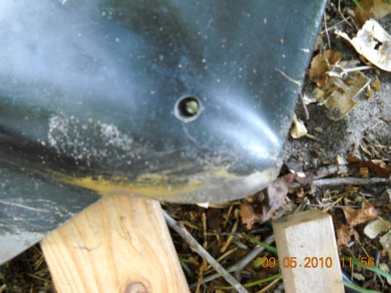

The slotted screw on the side of the lower unit, don't take it out unless it's leaking.
The oil drain is usually an allen head set screw on the bottom. Tach and stuff 003.jpg
