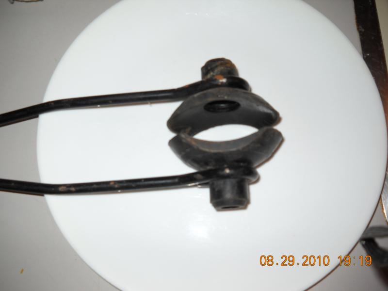

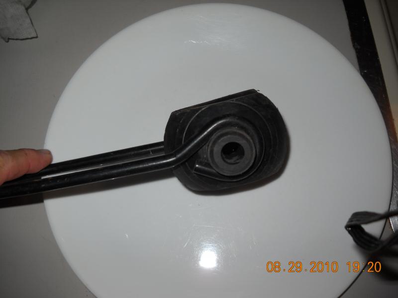

I'd take the lower off and make sure the copper tube to the motor is still in place.
Some water can come from the seal at the top of the pump.
But a lot of water should only come from the snout.
The hose muffs your using are the wrong ones.
You might overheat when using these.
The pics show the right ones.
