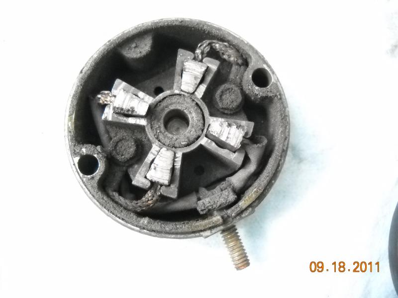

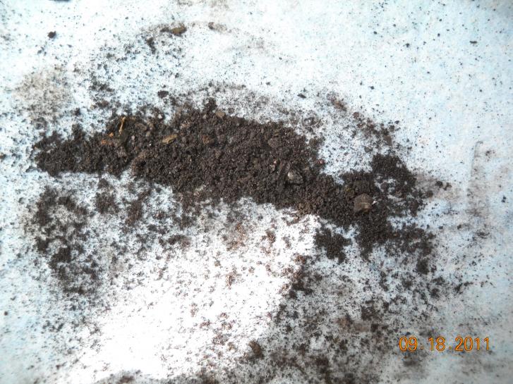

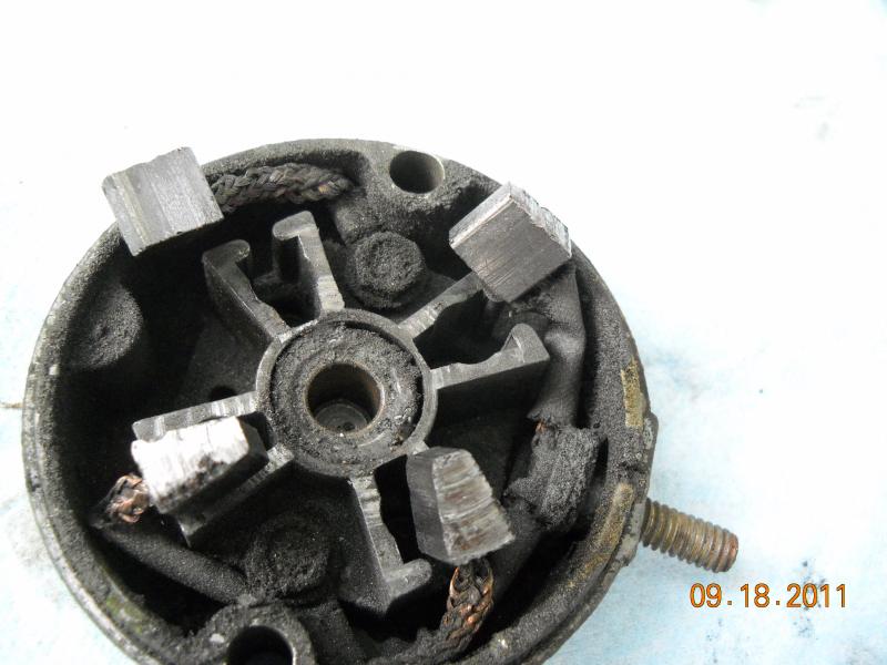

Too much grease on the shaft is a problem.Should be just a lite touch of grease on the worm gear.
The bendix has rubber in it and grease makes it slip.While it's apart replace the brushes too. Easy job.

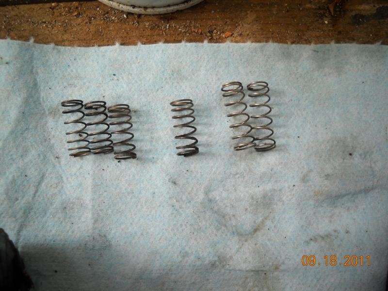

The springs are old(overheated) and new.
Make sure you get the right bendix.The one's for the newer starters will chew up your flywheel.
