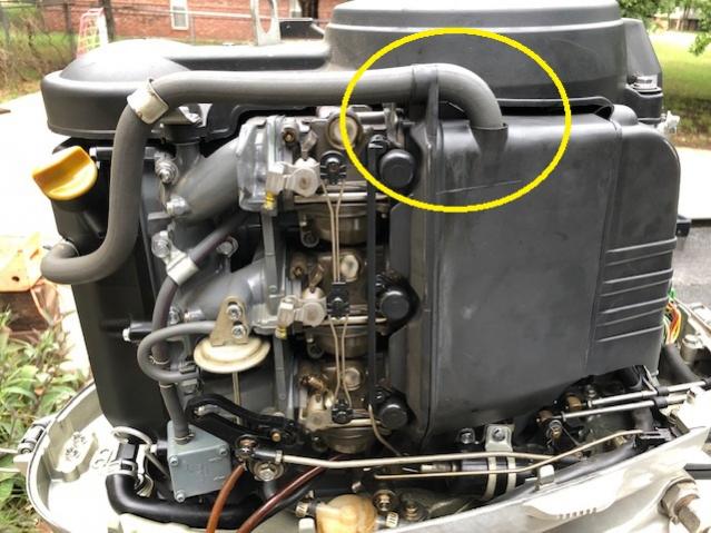

while working on my fuel pump issue outlined in another recent thread, I noticed this tube (highlighted) was unplugged from the compartment where it is plugged in now. It looked like it belonged "plugged in" there, like it shows now, and so I did so.
Is this how it should be or should it be unplugged and just sitting beside the compartment facing down?
What is the purpose of this tubing?
