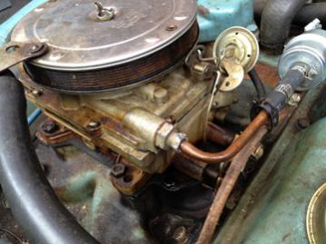

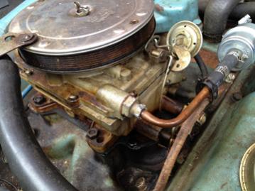

Hey Guys I just changed the carb on a 73 318 to a 1409 (thanks to the info on this Forum...Thanks)but my flame arrestor dose not fit now. I See that some are retrofitting but i am not sure mine is tall enough. Any one know anything about it? Or where to pick up a couple for a good price? Thanks.

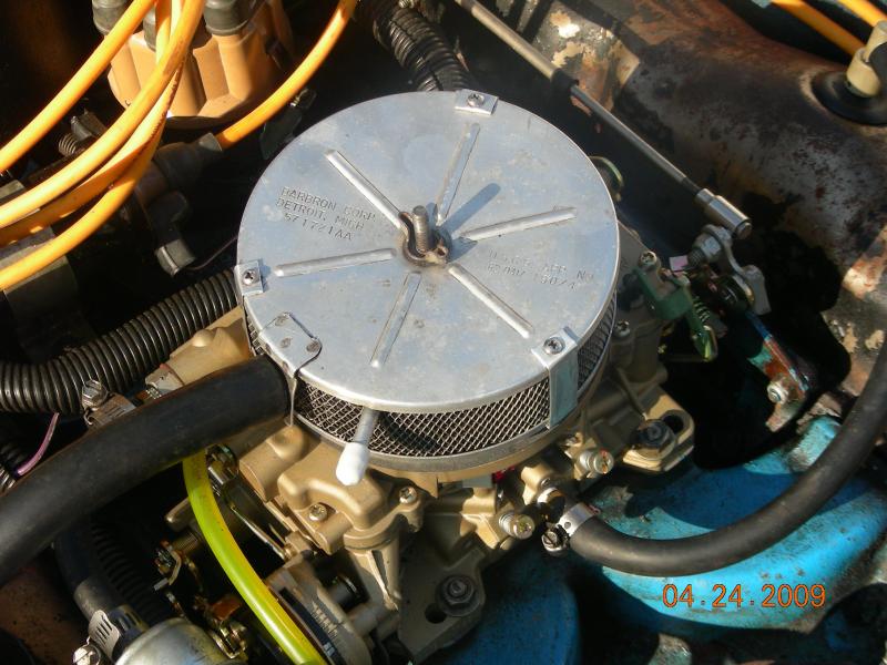

Looks alot like this one.

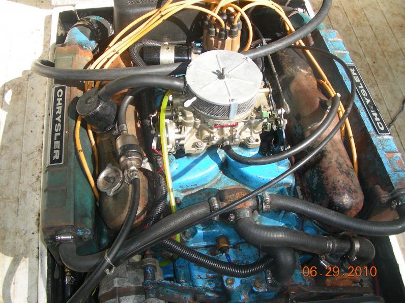

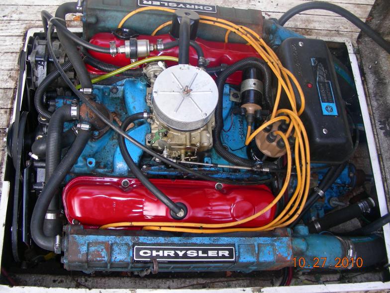

Being a cheapskate, I used the flame arrestor from the Carter AFB that I replaced. Had to increase the opening size a tad; an easy fix with tin snips & a file...
Me too! Had to grind on it a bit with a pencil grinder, but the little darlings fit just fine.
Jeff
PS: Are we related?
Ooops! I also used a carbide bit. Didn't mean to confuse the issue. (Those grinding stones are useless.)

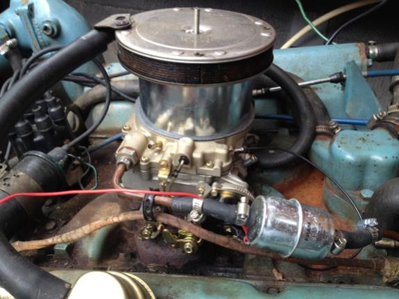

Hey guys what we ended up doing is using about 2-3 inches of 5 or 6 inch Heat ducting to raise it up and it worked great. The 1409 comes with an long rod anyways and it fit perfect. I will post pics when i get back out to the boat.
