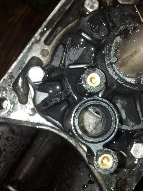

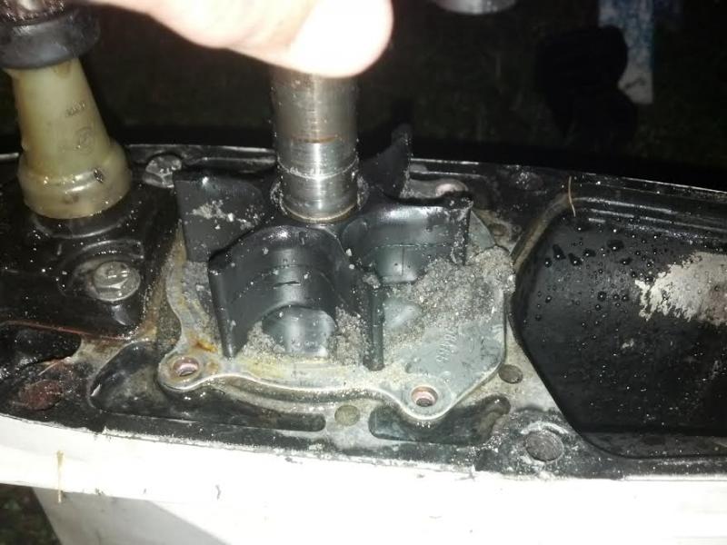

Thanks for the reply joereeves. I'vebeen stewing on this, running scenarios/questions past friends and other fellow boaters. I pulled the telltale plug and ran water hose with a large bin underneath so I could see what, if anything, came out. About a cup of sand came out. Then I pulled the stats and one at a time, flushed them with the hose. Tried running engine...bad idea...no telltale now. Now I'm concerned. Pulled lower unit...boatload of sand...still in water tube, throughout new pump housing...everywhere. Maybe two cups now. Cleaned, flushed everything. Cracked stat cap...will have to wait to run it until I get a.new one. I've tried to attach some pix...no luck...will let you know result in a few days. Thanks again for the help! Andrew

O.K. Here are a few of the pics from the sand purge...
