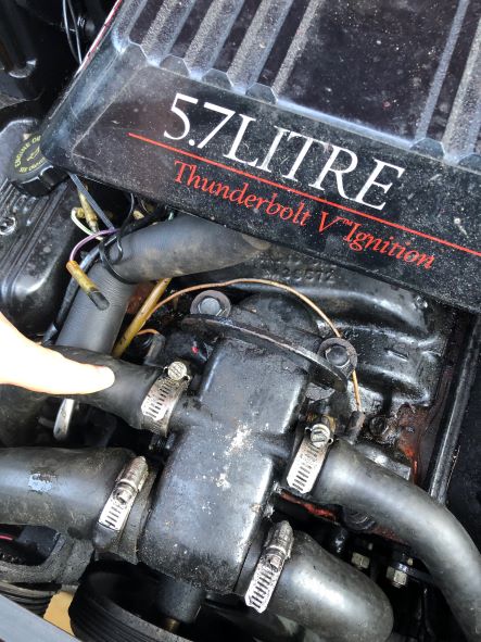

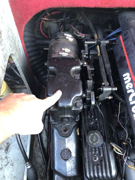

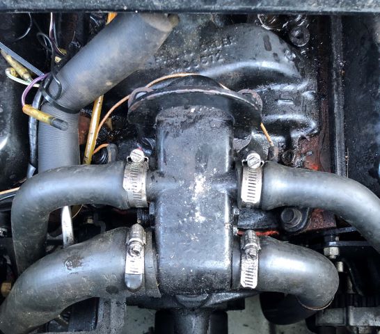

Im having issues with my exhaust risers being different temperatures. while I was riding today, I checked the risers and the left one (looking at the stern from the boat) was hot while the right one was warm. The temperature was ~175 and I had no power loss issues. i pulled the boat out of the water and pulled off the raw water supply line to the riser and hooked my hose up to it. water freely flowed though to the exhaust on the gimbal housing. I put everything back together and ran it on the muffs (engine was still warm but the risers had cooled off). after a minute or two, the left side was hot again and the exhaust coming out of the housing was hot on the left. on the right side, the riser was cool and the exhaust was cool.
im curious if this is normal or this is an issue. i though the risers were supposed to be the same temp and it doesnt make sense why both sides wouldnt be warm. is there some kind of casting in the thermostat housing that will route raw water differently. I did get a new impeller this year.
Anyone have any thoughts or run into this before.
