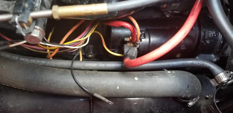

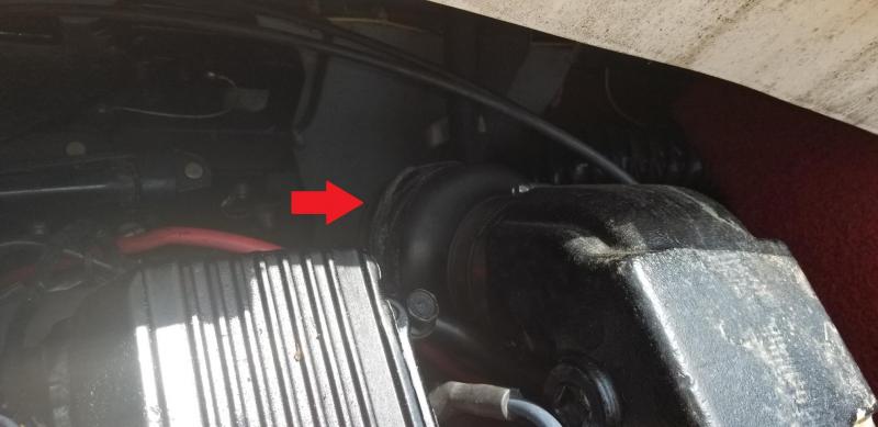

I just bought my first boat, it is a 1988 Glastron x19 with 3.7 Alpha One Mercruiser. I took it a out a few times with no issues, but I am noticing after I am in gear and put it back in Neutral, it idles between 2500-3500. I also noticed some smoke today and when I looked it is coming from a piece behind the engine that appears to have a tear in it (sorry I am not sure of any terminology yet) Pictures are below. The last picture is a ground wire that I assume should be connected somewhere but is not, any thoughts? I knew I was in for some work when I bought an older boat like this, Thanks!

the "tear" appears to be a burn thru on the exhaust bellows....due to a bad water pump or a corroded elbow....and should be resolved ASAP.
The factory harness uses "BLK" as ground...and it's there to ensure something is at a zero volt potential...
You need to seek profession marine mechanic help. You're on the verge of doing expensive damage here.

Update: As advised I did seek professional marine mechanic help. Replaced Starter, Exhaust bellows and shutter as well as impeller. I have $800 less dollars but I have a boat again!
