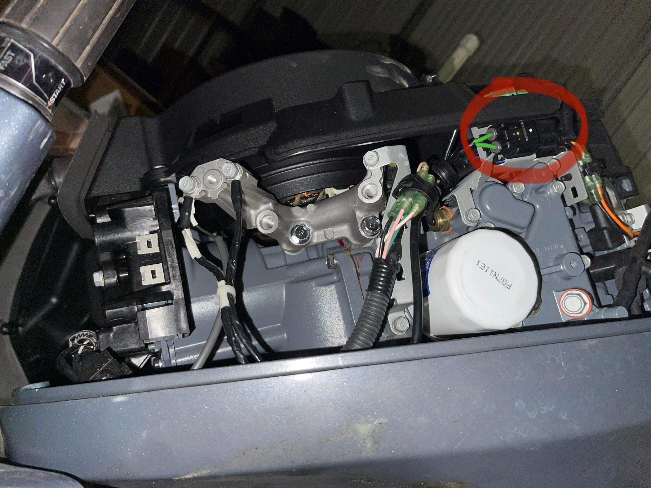

Hello all. I recently purchase a 2013 F25 SMHA outboard and want to be able to run electronics and charge my battery’s while cruising. I’ve found the rectifier/ regulator I need but what else is needed to convert it
Here is part number for rectifier I found.
Regulator 6BL-81960-00-00
Have you confirmed that there is something for the R/R to plug into?
Not exactly. I was going based off diagrams and the assumption it has the connections if it has the 14amp generator..bought the boat on Friday and I’m out of town working till end of the week. Maybe I should check that first
I believe that connector there is where the rectifier plugs in as it is blank and has the 2 green wires going to it
