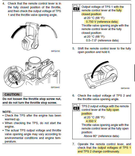

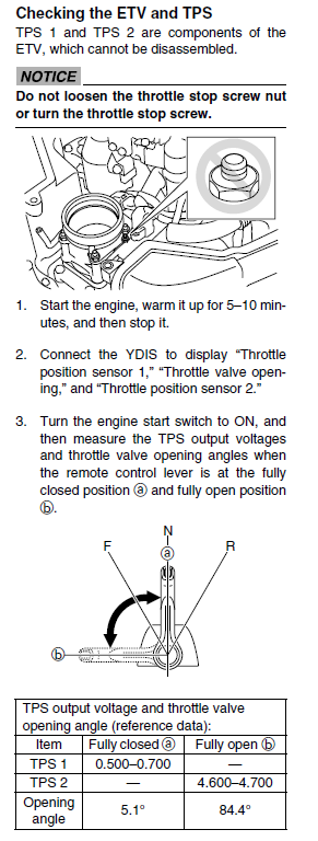

Here are the readings:
Green/Red. .044
Green/Black. .044
Pink. .001
Brown 5.06
Pink/White. 0
Readings were the same with the throttle in neutral and WOT
There is no brown wire colour to the TPS. There should be an orange and a black wire.
Black being a ground and orange being the 5 volts.
Volts are normally measured using YDIS.
What is being reported does not agree with what the service manual calls for.

Finally got some time and here are the volt
readings using a multi meter with the TPS harness plugged in. First numbers are idle second is WOT
Idle:
Pink. . .7 4.37
Pink/white. 2.8 4.68
Orange 5 5
Green 12.24 9.9
Green/red 11 12.26
