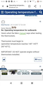

Here ya go, brother. If a motors operating temp is below 140, damage will occur in time.....especially on a 4 stroke where oil is recirculated. Furthermore, the hotter that you can safely run a motor.....note I said SAFELY.....the better it is for economy and efficiency. Why? Fuel is effectively burned, (as long as air/fuel mixture ratio is correct), and more power is generated. In the perfect world, the cooler the temperature that the fuel/air mix is presented at the moment of combustion, the more power will be produced......but.....the motor will be at full operating temp.

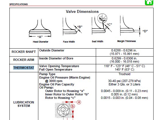

For clarification, here is the thermostat info from the manual and the serial number plate on the engine:
Okay thanks, that's very clear. The thermostat "begins" it's opening to regulate temp at 122, but max flow is not allowed until 145.
