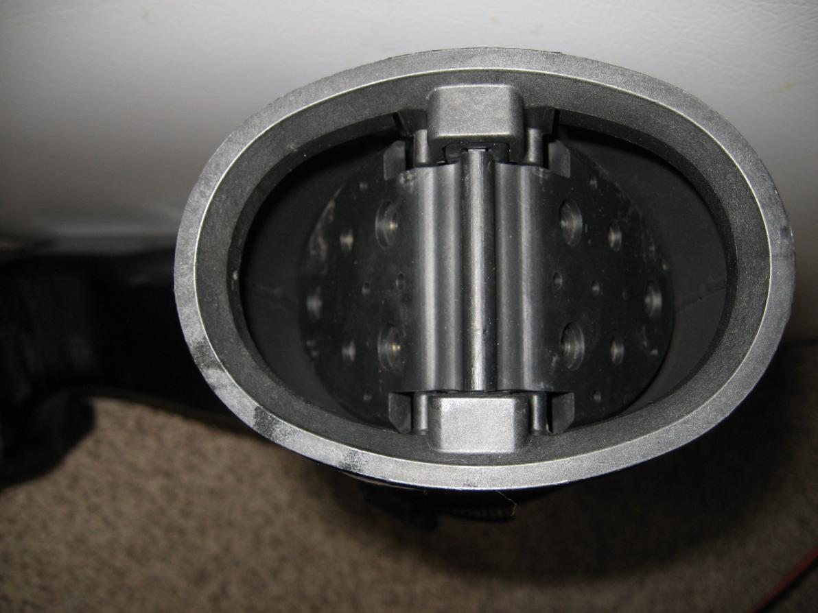

I'm not sure if the 7.4 exhaust y-tube is the same as the 5.7 Alpha, but those numbers are the same as what I replaced mine with.
Re: exhaust shutter design change?
Thanks,
This is exactly what I was concerned about. Is this an "official" Merc fix or is it something that just works?
That's the genuine Mercriuser part #. (maybe even Quicksilver? but not sure)
Sierra makes the same shutters under the part #18-2649.
