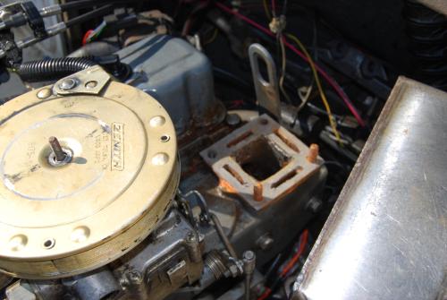

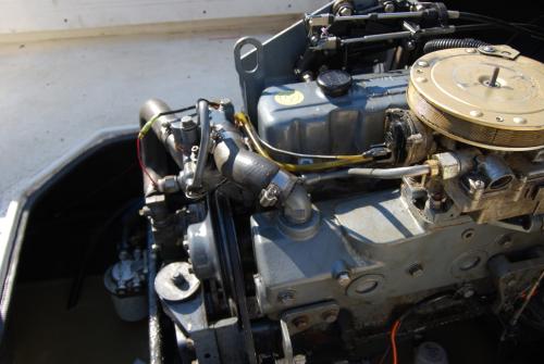

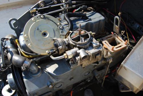

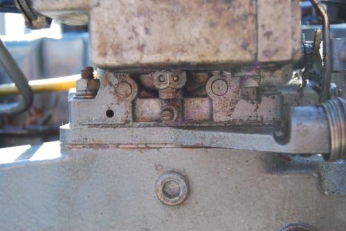

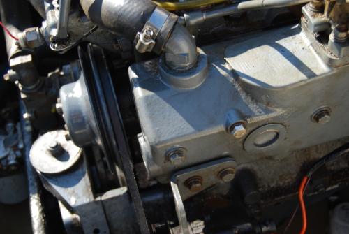

Here are a few Pics of the manifold, hopefully they will help.

Ok Your problem might not be related to the mani but the head.
See if you remove the t-stat housing off the head , and look into the neck with a flashlight, and probe the opposite wall with a screwdriver gently see if that wall is solid or a hole opened into the hole for the pushrod allowing water into the oil.
If you take the valve cover off you will see how close the first pushrod hole is to the neck it is a thin wall. Want to try that before you start spending 300 dollars for a new mani you might not need.
Also i think the omc mani might be closer to what you need for a 85 i think motor . I will look it up and post back to this thread within the hour.
And by the way what is the compression right now on the motor today ? All the plugs out and the throttle down ? Use a screw in type compression tester.
http://www.marineengine.com/parts/mercruiser-stern-drive/mercruiser-engine-parts.php?modelId=2830&model=3.0L%2FLX+GM+181+I%2FL4+1990-1995&serialId=2831&serial=0C856559+THRU+0F603999&componentId=2
Here is a merc one piece. I knew i saw one in person a very long time ago. But i can't see the mount for the cable.
Another thing i don't know if your carb will mount up. You got one adjustment screw. The rochester 2 cg has 2.
