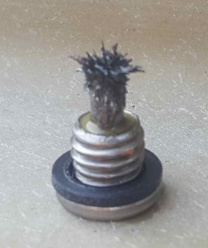

I have the problem that makes our age-old (1969) Almar 16 foot boat with the hitherto superb running AB Evinrude 135PS Type 135483B, 4-cylinder, 2-stroke from 1974 difficulties.
We use the boat exclusively for water skiing.
The difficulties initially expressed themselves over too low idling. The engine died when going in gear.
Unfortunately, we have always increased the speed by using the cold start rotation lever on the remote control. (Not choke)
At first, at full speed, there were blows from the engine with little thrust loss at undefined times. These piled up then. First guesses were dropouts of the ignition or even the fuel supply. (sealing LEAF PLATE in the intake channel)
But the last ride ended with a boat that was no longer moving forward. The throttle / gear lever could be moved forward the forward gear was engaged but then jumped out immediately and with a "vibrating" throttle / lever.
Driving was only possible backwards.
The remote control I have disassembled and can find little wear or damage.
Now the question:
I have it possible that the transmission (jaw clutch, shifter, clutch dog) has survived and only the circuit needs to be adjusted?
Does anyone know about these antique things?
Please excuse my English!
