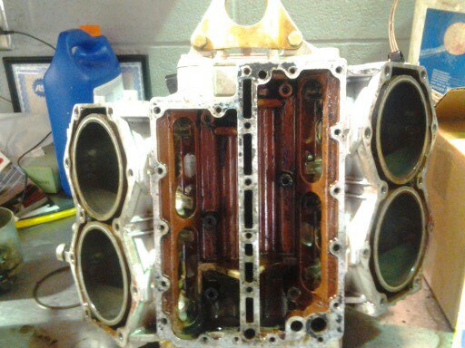

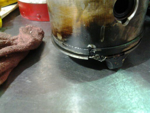

model 85995R, last time out my motor lost power and wouldn't idle, after discovering a dead cylinder and a water drip from the exhaust cover, I removed the cover and spotted damage when I looked in the ports, so I pulled the head and now I need to replace the piston, I wont be able to order a service manual for a couple weeks so am trying to pull the powerhead and not sure where to start. can I pull it on the transom or does it have to be removed from the boat? I am an auto mechanic so I'm not totally clueless but this is different and could use some direction till I can get my manual

I have removed the plastic cover, and want to know if the exhaust housing adapter comes off with the powerhead or does the power head come off the adapter, is this piece similar to the bell housing on a car motor?http://youtu.be/4AchZyYCcHs
ok, so after searching threads, I understand I need to remove the 6 long bolts that go up through the exhaust housing adapter, the 2 nuts under the back, the 4 bolt up front, and the pin from the shift rod. am I missing anything?
the cylinders look good, still have some crosshatching. I was thinking of replacing the piston, and re ringing the other 3, and replacing all the gaskets. not sure why it broke.

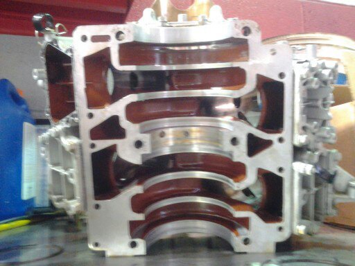

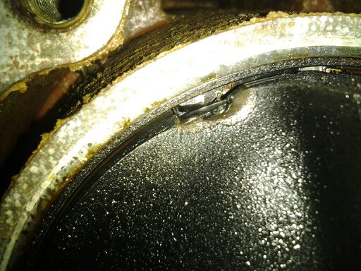

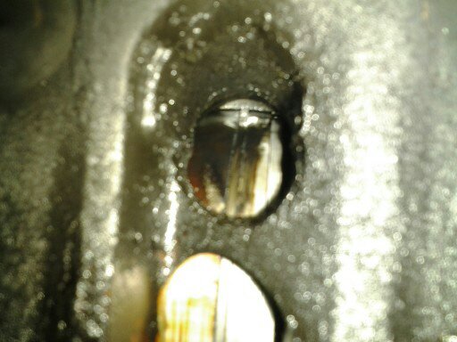

stayed late at work, cleaned the ring grooves, then used the parts washer, maybe get more tomorrow

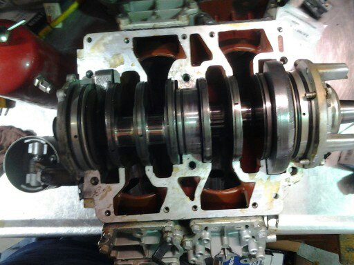

ran into a big problem, the crankshaft was broken where the bottom seal rides, I have re-attached the pieces and machined it, now waiting for a repair sleeve I ordered today, and pray it holds up, as replacement cranks are unavailable
I did not think of a used crank, but the sleeve worked great, and the crankcase is back together now. just need to bolt on the heads, stator, flywheel, intake, carbs and set it back in place, but first this looks like a good opertunity to replace the thermostats

My concern is that "broken crankshaft", and how did you fix it? I would really like a complete explanation of that one...
you reattach the broken pieces then grind the weld smooth then drive speedi sleeve (napas brand, advance sells redi sleeve but they didn't have 1.112) over and viola, smooth perfect seal shaft

You skip right over the hard part. Reattach. How? JB Weld? Seriously, how did you weld it? And you must have access to a machine shop where you can experiment. These cranks are hardened and I was always advised they couldn't be welded.

jb weld, then a skim coat under the sleeve, I would not do for a customer, some of the things I do to my stuff, I think it will hold up fine though I wont stake my reputation on it. so far so good, if it should fail, guess I start the kicker
