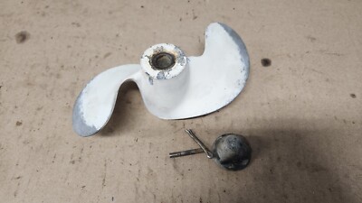

What year??? I am thinking a couple of motors went into making this old one I have. The serial number is 6202DJ014 939
I am going to get this one going for the kids to drive around and wanted to get all the original parts for it. Thanks!
A 1972 model.-----I have more than a dozen of these 6 HP motors from 66 to 79.-----These are the finest fishing motors made.-----Easier to get the parts than for some newer motors.----Pull flywheel and inspect coils.----Inspect thermostat ( often see them stuck open ) on top of cylinder head.-----Install new water pump impeller.
Well I just checked on this website, ouch! $235 for a prop! I don't think so. Look on ebay. Pretty sure that prop fits on early 60's 5.5hp and 6 hp with pin drive
