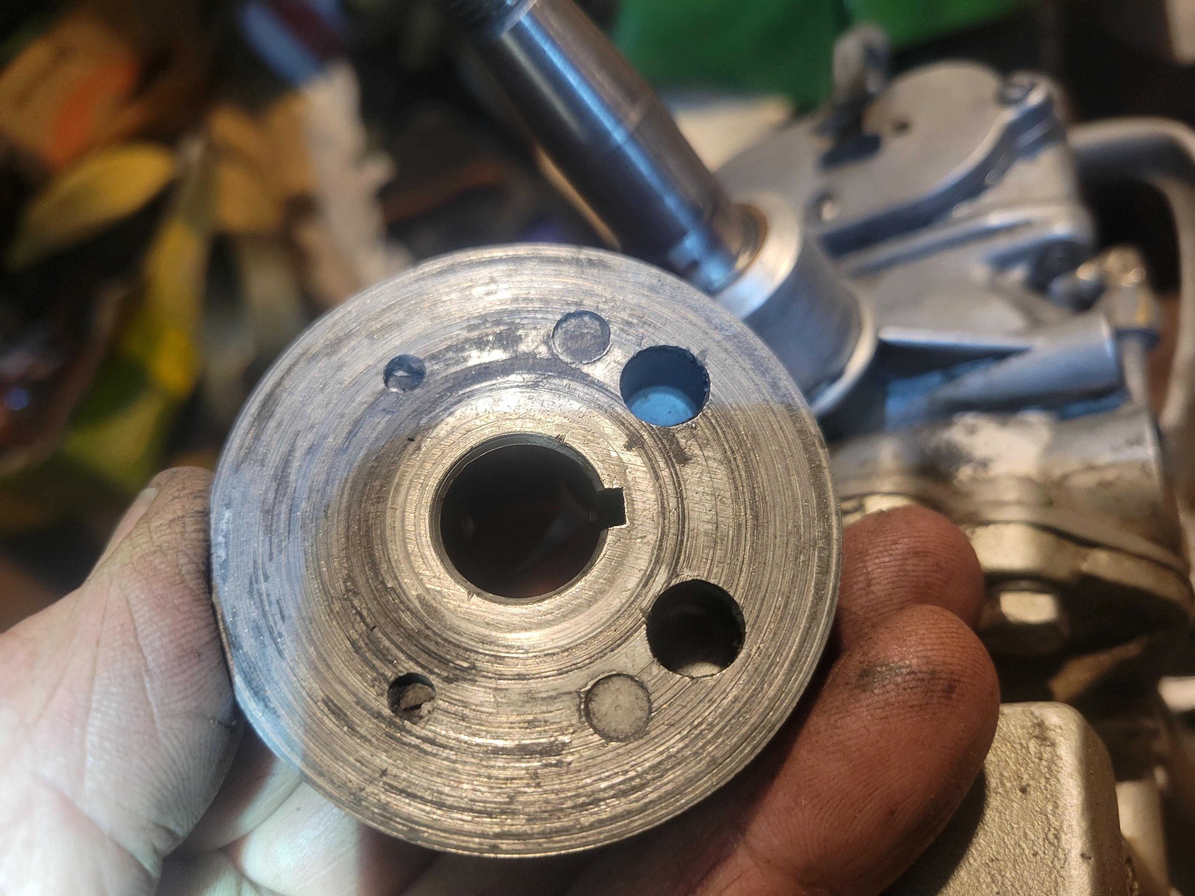

Hi, I'm asking if anyone here has a solution for stator and magnet ring contact....see in photos. This is a real virgin, but filings of aluminum were everywhere. The magnet ring has a chamfer that it bottoms out on but what actually holds the stator plate down against the block? I've been at this a long time but I haven't worked on many of these and it's the first time I've seen this. Might have to appeal to somebody like Racer who probably has run into this before. I'm restoring this for somebody in Alaska and it should be just a perfect runner with no problems. Thanks in advance to anyone who can make some valid suggestions here. Tim

Seems that there is nothing to keep that stator plate down other than the tension of the timing lever against the bottom of the fuel tank?
