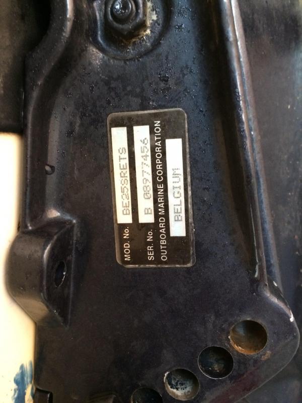

I've recently brought a Eurosport 13 4m fishing boat. originally had a Yamaha 70hp on it, but the block cracked.. A friend of mine gave me an Evinrude 25 either EV or ER model but I'm unsure of the year (late 80's early 90's black casing) this week I've fitted the 25 and attached the steering, changed the throttle box, ect.. The engine itself looks like it's had very little use, good compression, spark. I've changed the plugs, had the carb off and was spotless inside, I've set the timing marks to the correct place and the butterfly is opening fully on full throttle. Yesterday I took the boat out for it's first test in the sea.. The engine ran well i was out for a good hour but the top speed was not correct. sounded like RPM was getting up there but the top speed was low. The only thing now i am thinking it could be it the high speed screw restricting the fuel as i didn't adjust this while out yesterday.. dose anyone have any other ideas of what could be causing this problem? I've been a mechanic for a number of years but this is the first outboard engine I've ever worked on and first boat I've owned... Any help would be much appreciated..
