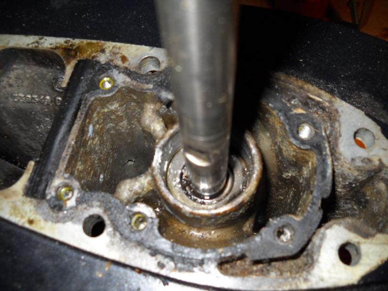

Salt water got to it. I am talking about driveshaft that has those bearings. I was going to go thru it and replace seals and bearings.
If you don't have a manual you better go to shop.evinrude.com and look up a parts diagram of your gear case.
Yes , all is down to bearing that are in upper housings. Could the bearing have come apart and binding inside.could not get photo to upload
All things being equal the shaft should have just slid out,right? I am going to replace all the bearings i just didnt want to mess up the drive shaft $$. Thanks for all the replies !
