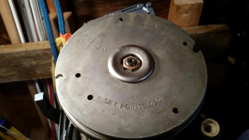

q2 See picture. Holes on top don't look like either 180 degrees or 120 degrees apart. Are there more under large washer?

The holes you will be using are under the shiny cover held on by the flywheel nut. Put a ratchet strap around the flywheel and push against it while loosening the nut.You can always sleeve your wrench with a piece of pipe or something.
