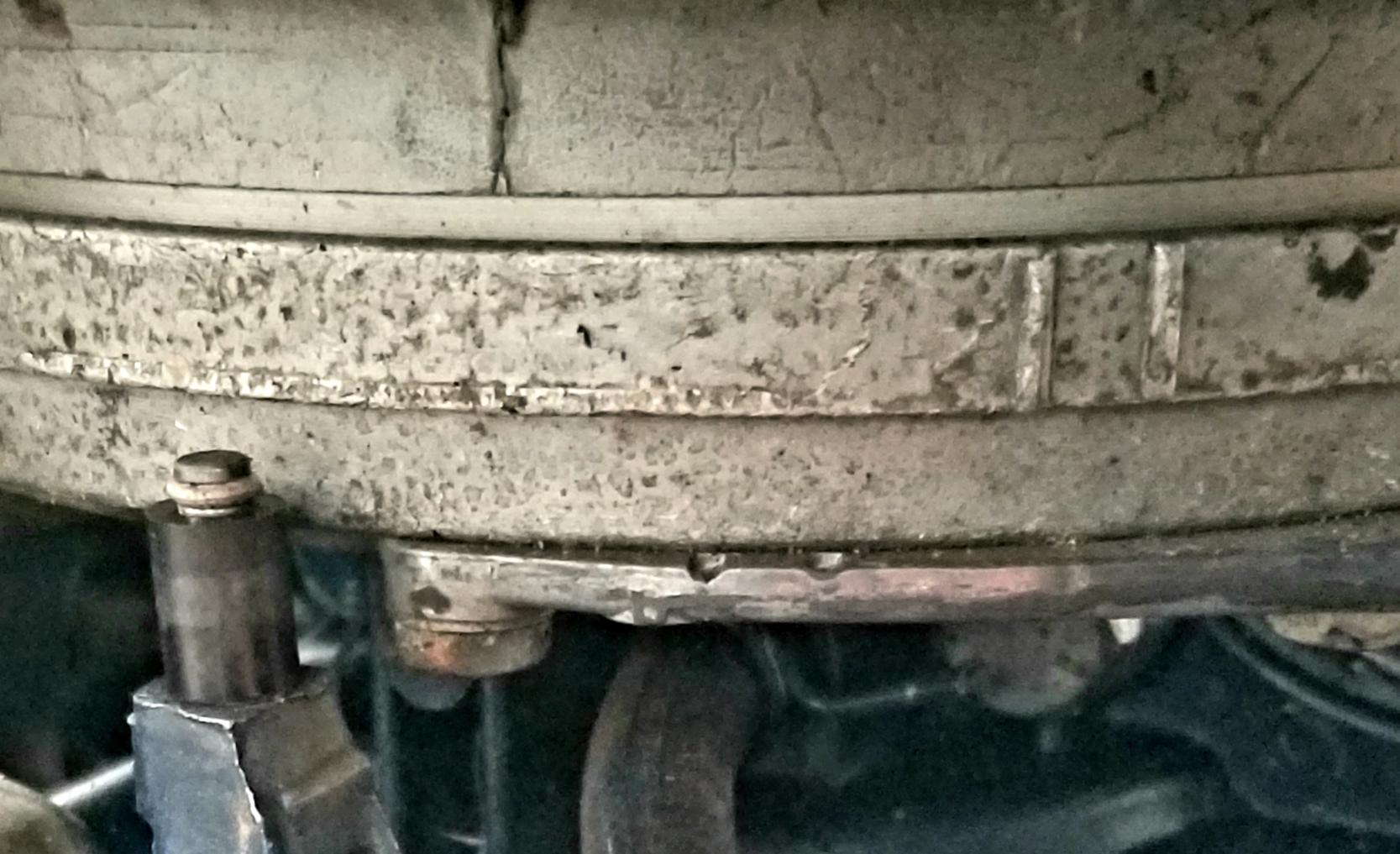

I bought this motor a few weeks ago. I think it had been in this man's barn for a few years, but once I got a fuel tank hooked up and a good battery, I have it cranked and running. I think maybe the throttle linkage is out of adjustment, when I twist the tiller handle it doesn't seem to be WOT. So, I'm not a boat mechanic but...I see where there are two marks on the flywheel and how the cam roller starts to move when the tiller handle is twisted all the way to fast. That roller is nowhere near the two marks. I would appreciate any advice so I can get this adjusted properly.

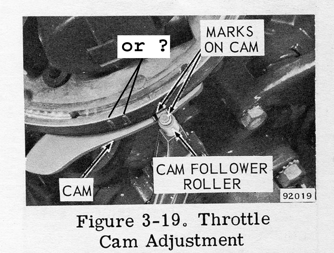

NO. The two marks are where the carb throttle butterfly should just barely start to open when the roller is aligned with them. At WOT, the two marks should have moved way, way past the roller
Good luck with your project.----But motor must be in gear to go full throttle.----The nylon pin at the bottom of the vertical shaft ( port side ) broken or missing ?
Let's all get on the same page here. I don't think we are all talking about the same two marks. I read it to say the two marks on the cam. Others are thinking two marks on the armature plate, others thinking the two marks on the flywheel. ​So, which two marks???
BTW, if your picture won't post, it probably is too big.

You are not going to wide open position. At WOT, the cam will have moved to the right till the roller has climbed up onto the hump on the cam. Find out why it won't go that far. (Not in gear, tiller gears out of whack or ????) We can't see the problem from here.

Thank you. That's what I suspected, that I was not actually WOT and in that photo it was in forward gear. I will try to find a service manual on eBay or Amazon and If it still can't get it right, I know someone who can, just have to pay him. It would probably be worth the $200. And I won't do any fishing until March anyway.

Found a diagram, cam is mounted on the armature plate. So are the tiller gears what determines where the cam is in relation to the follower?
