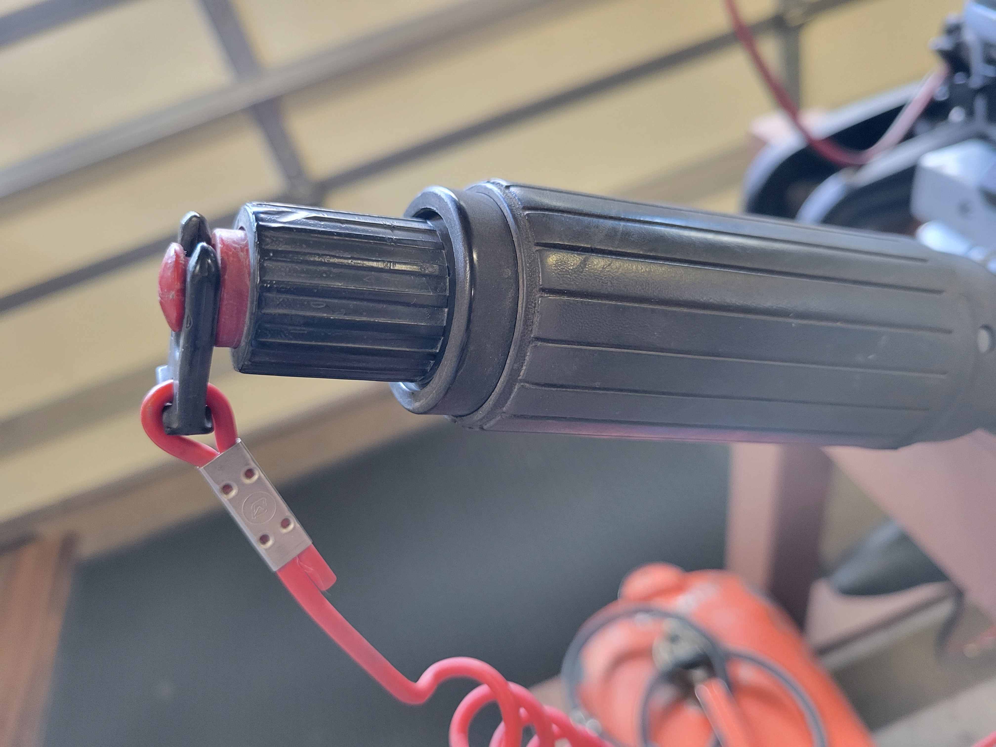

I recently picked up a 14' Klamath with an '88 Evinrude outboard (Serial # = E 15 R CC S), I am new to outboard motors and am curious of the functionality of two motor adjustments.
The first is a rotating knob protruding from the throttle . What is this to be used for?
The second is a dial knob between the choke and rope pull. what is this for?
see pictures for reference.
Any help/guidance for specific operating conditions would be appreciated.

The dial knob on the end allows you to adjust low speed RPM.-----The other knob is the low speed , idle fuel / air mixture control.----If you just picked this motor up, I suggest a new water pump impeller.------What is this motor doing / not doing ?
