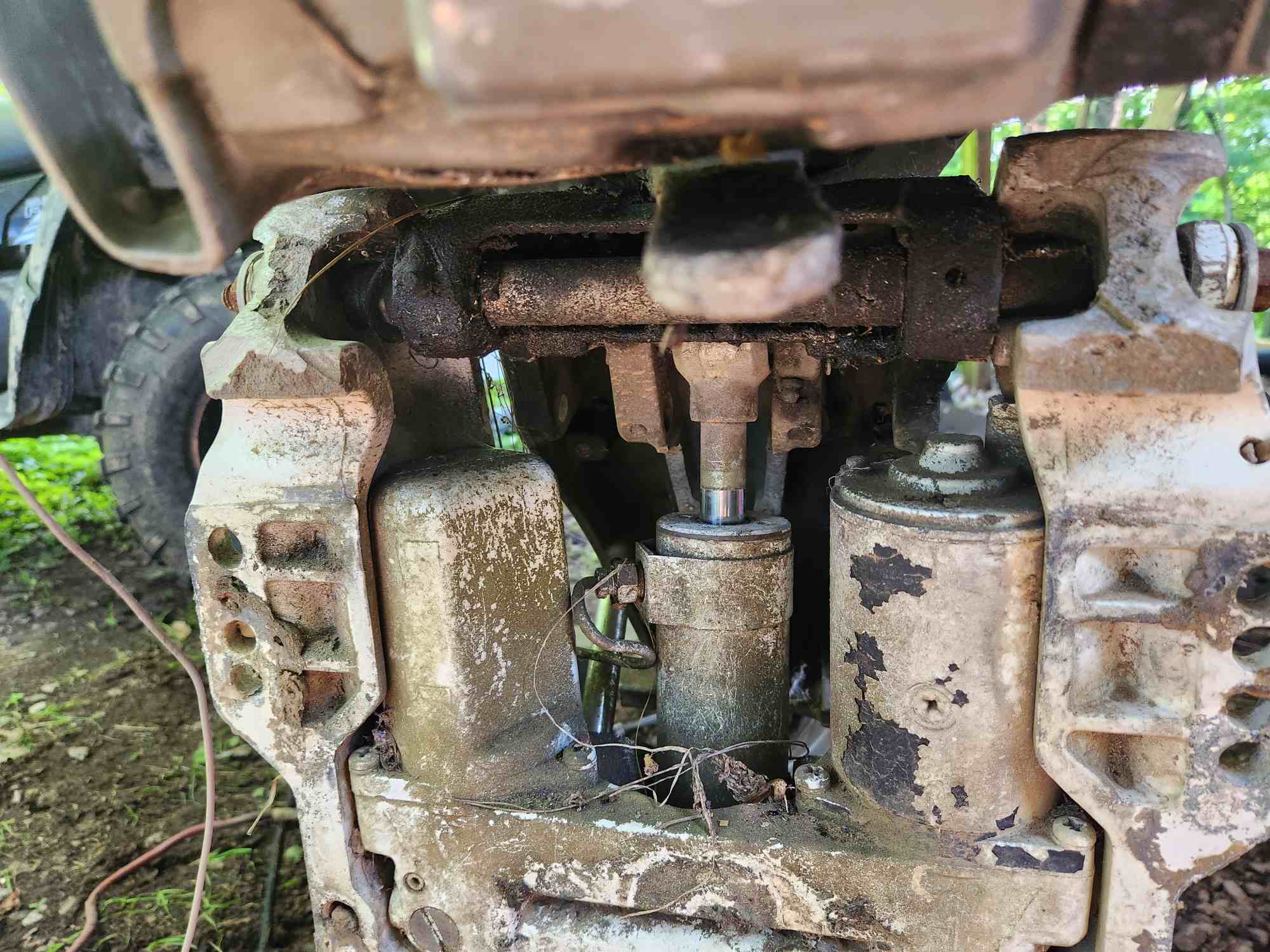

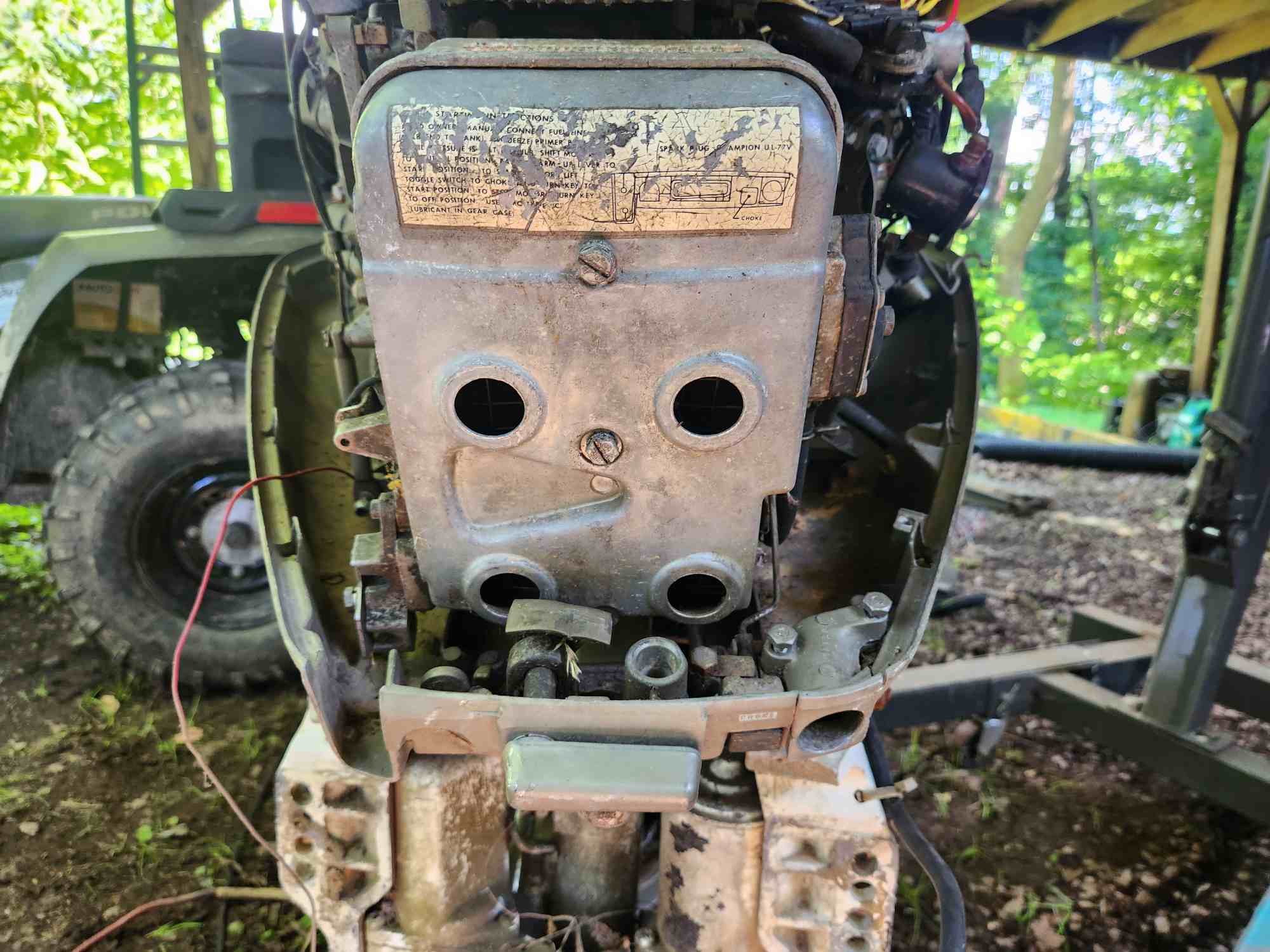

I think it's what the tag in the photos says, but the top hooks on the transom mount are broken. Does this look like what the tag says?
Thank you! Why would they have cut off the transom bracket?The motor is a 73 model.-------A 1 year model as far as engine internals go.----Those brackets and trim are of a 77 or newer motor.----ID / model # plate was switched over I think.
Well I already walked towards it so...Walk away from this thing....The original power trim and tilt system has been obsolete for 30 years.

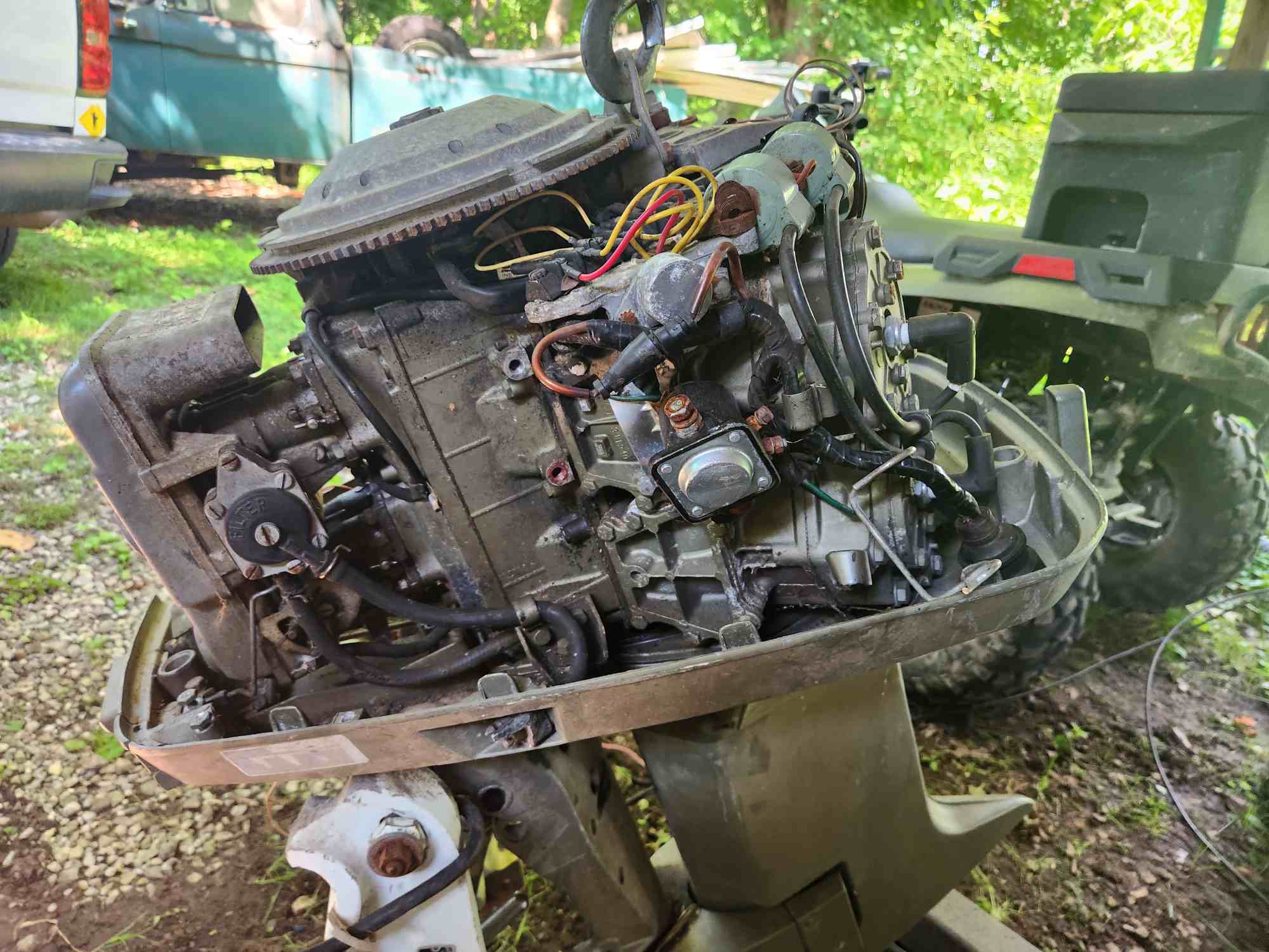

Will do. I'm running an 85 force now so a literal anchor will be better.Do Compression test before you spend a dime on this thing. These engines were notorious for breaking piston rings.
I usually see if they run, then make them run correctlyI've brought home quite a few "clunkers" in my time. I've learned from my mistakes, and I'll share my steps to help you not throw away a lot of money. If you turn the key, does the motor spin? If so check compression. If compression is good, I spin the motor off and check for spark. If I have good spark on all cylinders, I stop spinning the motor over and I replace the water pump and I remove and thoroughly clean the carbs and install carb kits. At this point, I get a good, clean, known to be working gas tank and fuel line and I start trying to crank and tune it. I highly recommend searching for a carburetor diagram using your model number and looking it over and finding where the main and pilot jets are and make sure you clean them really well. Lots of the old Evinrude motors have plugs that have to be removed to get to some parts of the idle/pilot circuit passages.
Well I have a heavy hull but I think it should be better than the force I have nowOne of the more powerful models made.----Fast on a light hull.
