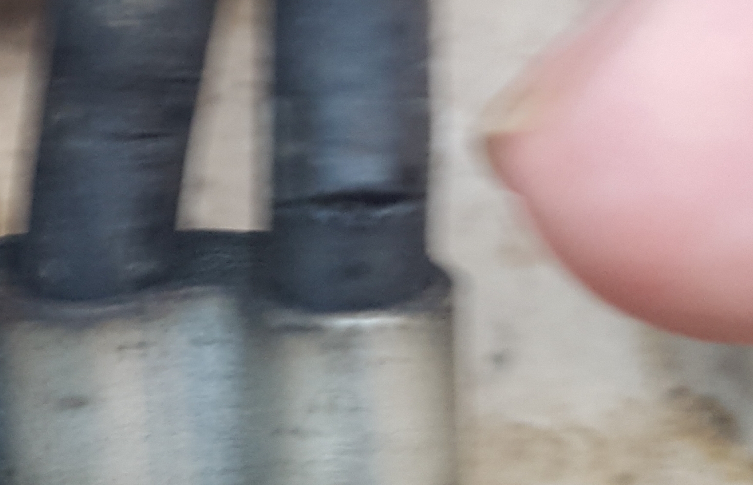

Think I found my problem trying to upload. Wires were ok EXCEPT a nick in wire under holder
For photos, reduce size to under 1000k....then they go through.
Good job. Can you get a photo of the coils too? They have likely been replaced, as Gator mentions. As Joe Reeves reminds us, make sure you "screw" the new copper core wires onto the coil pin/barb. I'm restoring a 1972 40 horse over the winter. Probably will replace wires too. Why? They get brittle from age....draging on the stator movement and eventually cracking or rubbing through.....because they are too stiff.
