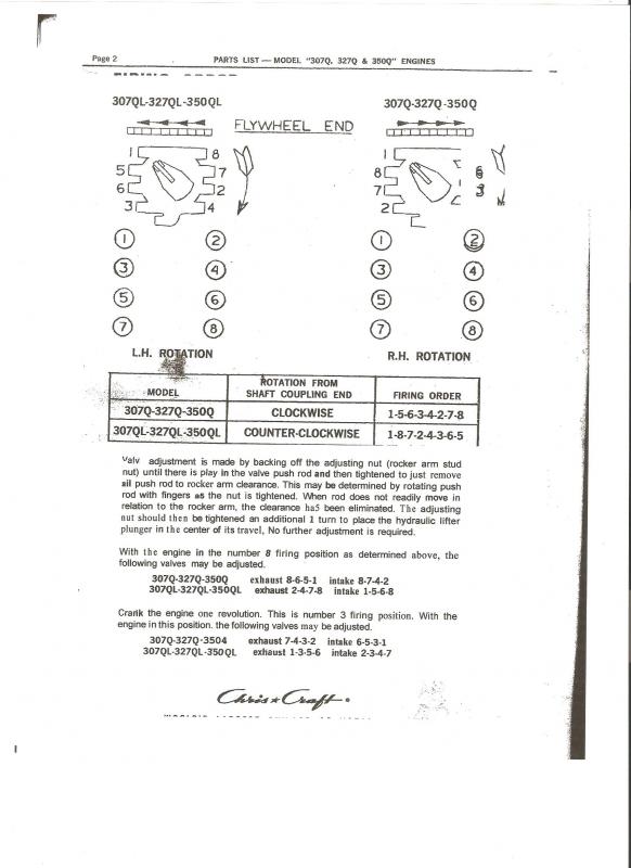

I have a 1982 350 Catalina with twin 350's. The port engine is a 350QL and has L.H. Rotation and the starboard engine is the 350Q and I am assuming that it has R.H. Rotation. Am I correct in my assumption??

From what I have read and my small amount of knoledge about engines you should look at the engine from the front and typically the flywheel is in the rear. Thetumbleweed
HmmmmmThetumbleweed said:You will only see me post a question that I am not sure of the answer and only answer a question that I completely understand and have documented evidence that the answer I am giving is correct.
As you can see from this image from my Chris Craft parts list if I were to view these engines from the flywheel end they would be rotating in the opposite direction from what the literature is saying. These are the engines that my question was directed too not car engines, Volvo Penta's or any other type of engine other than a Thermocon Marine Engine by Chris Craft.I fully understand that. However, would you agree that this has little to do with the actual "hand" or "determined rotation" of the engine?Don't assume anything. I did a repower on a Silverton this past summer the PORT ENGINE WAS REVERSE ROTATING!
And respectfully back to you! (don't have a first name for you)Rick,
I believe I have come across with a solution to the controversey about engine rotation. If we change our verbage to "look at the engine from the transmission end" it wouldn't matter if the flywheel was forward or rear we would come up with the right rotation for that motor.

Ditto, Chris! Wear pattern, on one side of the gear teeth, will certainly determine which direction the starter motor has been engaging and drving from!Rick, ............. I was just pointing out that all the reading and diagrams are a great thing for reference, but, nothing will substitute actually physically looking. If the engine is locked up, pull the starter and look at the gear or.......................
