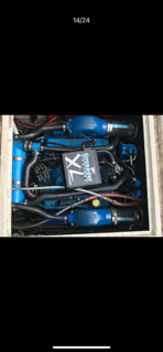

I got a new one but it won’t push into the block. The bolt pattern is correct, but the edge of the starter won’t go in far enough to even thread a bolt. Caledl the starter people and they told me that they told me that I need the year or type of the Crusader engine.

assuming the flame arrestor cover is original to the engine, the XL says its a 1992 or later built engine...the U-shaped oil cooler suggests it is a big block vs a small block...so most likely a 454CID. Given the orientation of the exhaust, it appears to have a V-drive so it likely has the flywheel cover mounted starter...so you need to figure out the rotation of the engine to get the correct starter.
The pre-XL versions had the ID plate on the flywheel cover, up under the heat exchanger...the XL versions had the plate mounted to the engine block...the data I have doesn't say WHERE though...there should also be a decal on the valve cover that may give you the rotation.
another item to check is the timing tab - if you can ID the BTDC marking, you can determine the rotation from that. worst case, an educated guess can be made from the drive gear on the starter...
