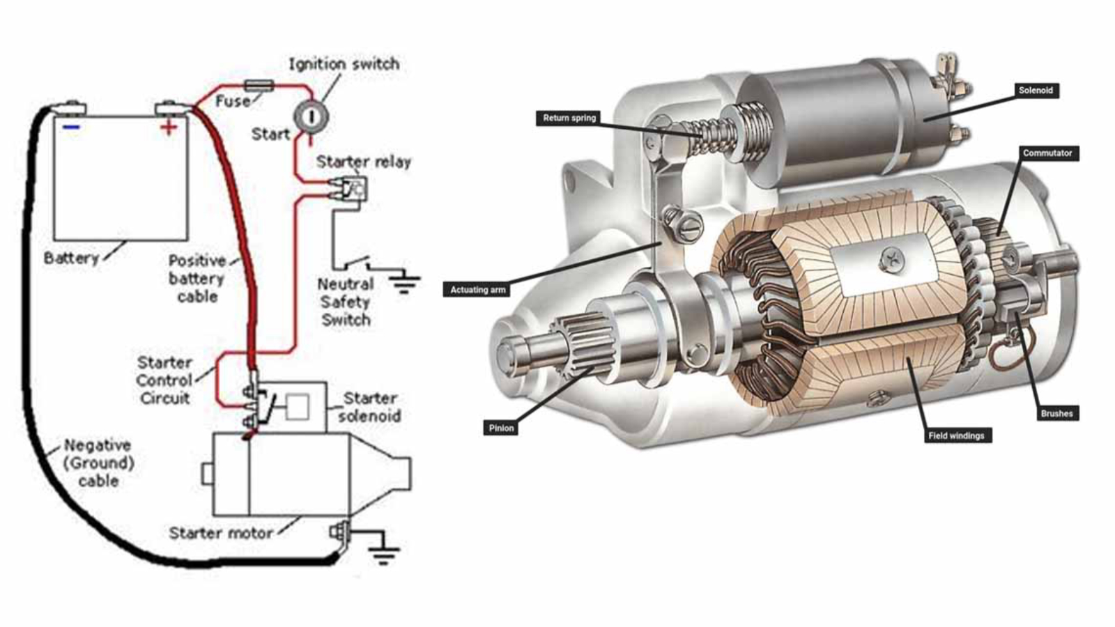

Your starter solenoid will have 3 posts. 2 heavy duty and a smaller one. One of the heavy posts is connected to the starter motor and the other to the battery + cable. The small post is the control circuit to energize the starter solenoid. Internally in the solenoid is a plate that contacts the two heavy posts, allowing power to the starter motor. Normally the plate is held away from the contacts by a spring. When energized, the solenoid electromagnet overpowers the spring and allows contact.
To test the starter solenoid run a wire from the heavy post where the cable from the battery attaches to the small post, sometimes marked with a S.
This will cause the starter to run if all your connections are good.
The reason you push the button 50 times is either you have a bad connection in the positive or ground wiring or a contact, probably in the ignition wiring, that is pitted, but eventually makes contact. When checking connections, check the ground, too.
Once you sort out the starter problem, reinstall a relay for the start circuit. The reason it's there is so the current doesn't have to run to the control station and back. With the relay the length should be about a foot. Otherwise you will burn out contacts in the ignition switch or start button.
