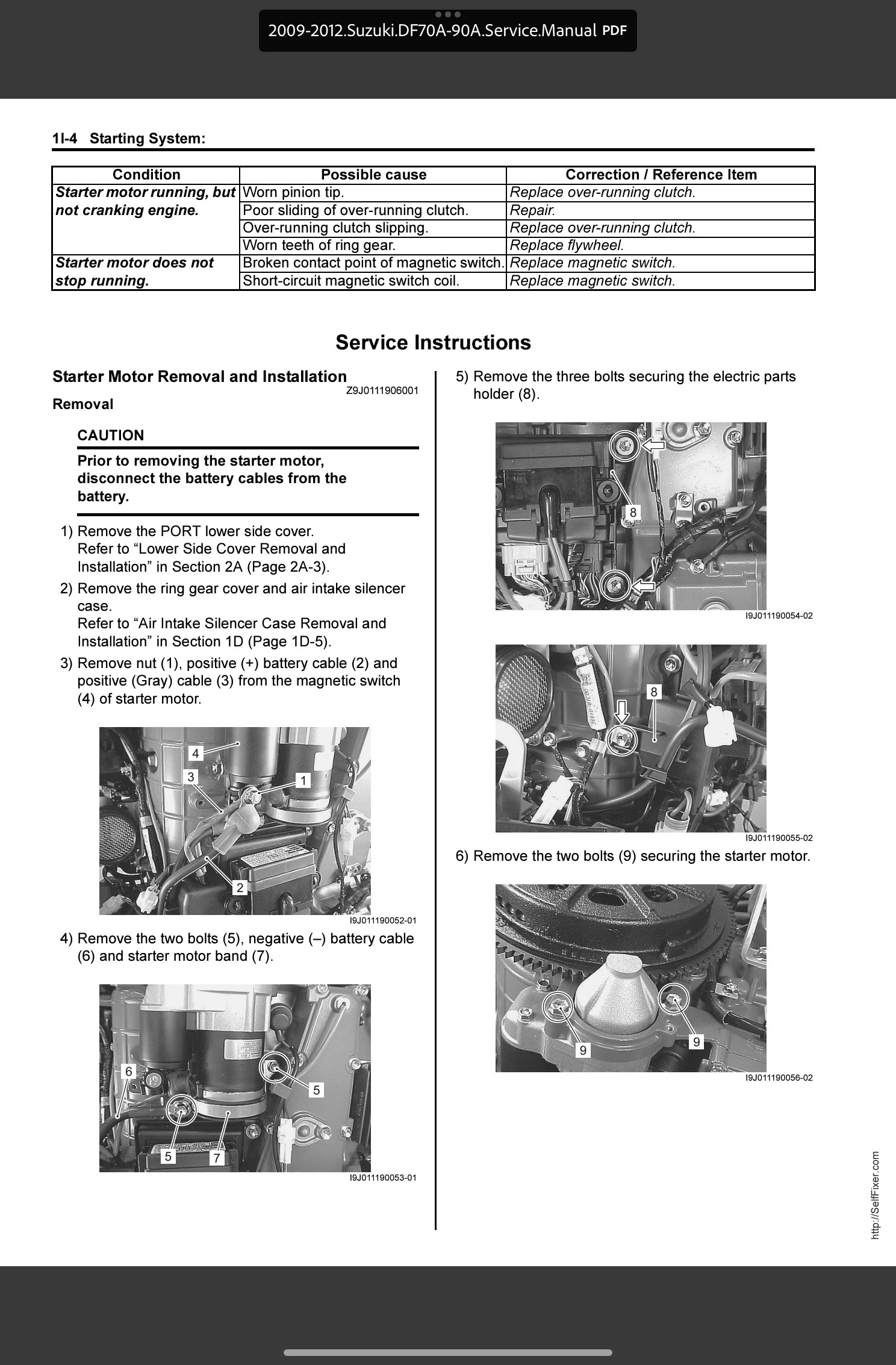

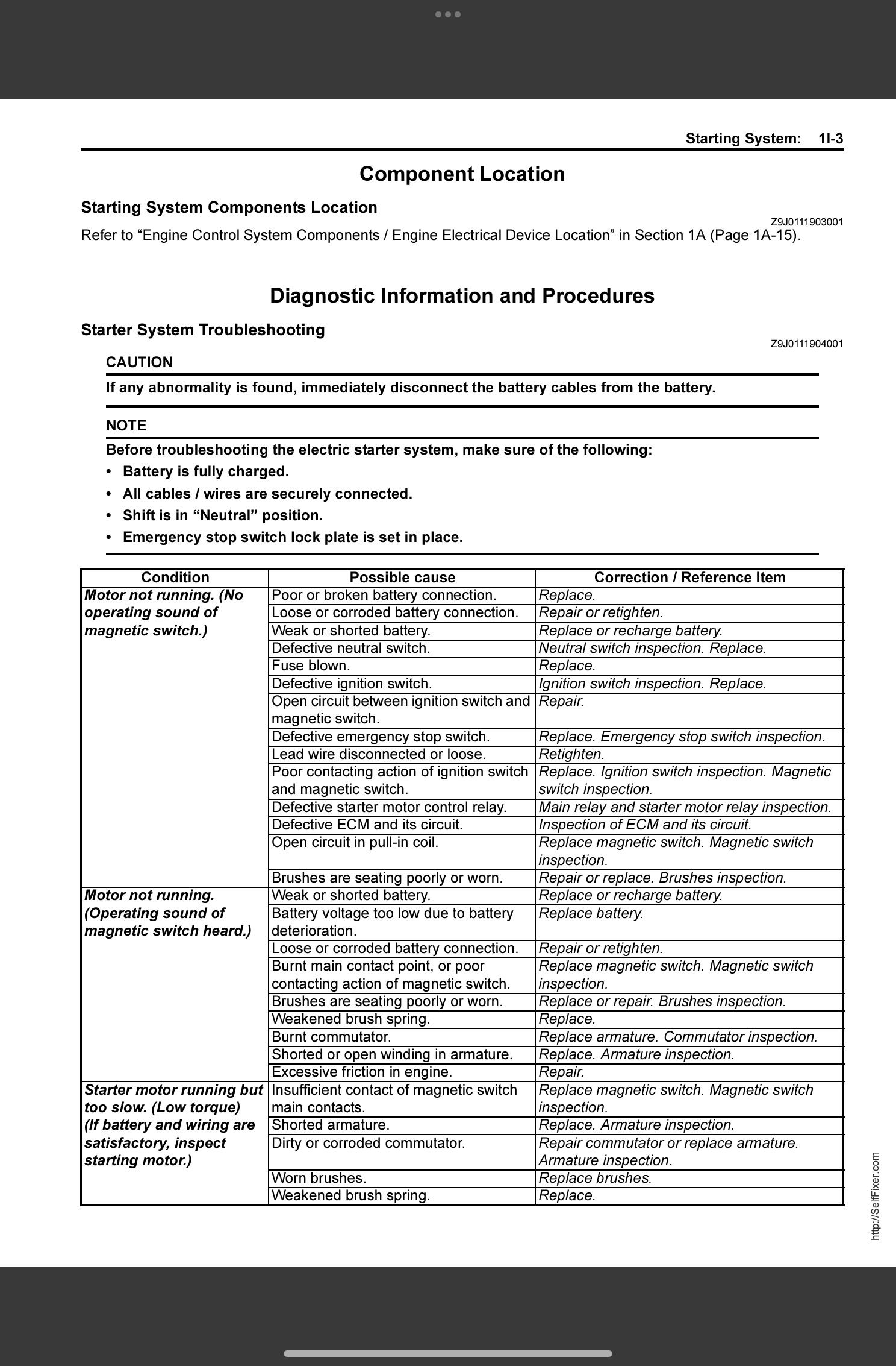

Below is a screenshot from my 2009 DF90A Service Manual, different engine than yours but it might help?
